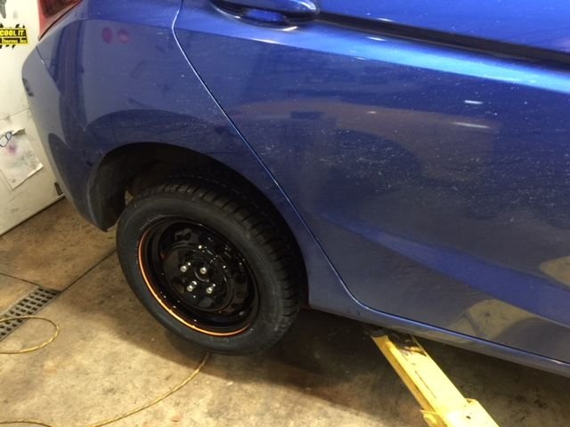

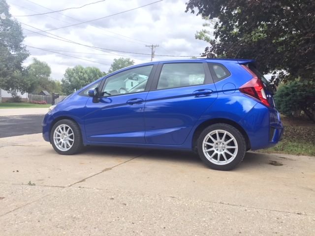

I guess you have better luck than me? At first I thought it was great to not have to buy sensors. Personally, I think the system sucks. I have to reset the TPMS numerous times when switching back and fourth from daily driver wheels to autocross wheels and the same when the winter tires go on. I use a $180 Longacre tire pressure gauge accurate to 1/4 of a pound to set the pressure. I also have a Joe's pressure gauge that reads the same as my Longacre. I assume correct pressure isn't the issue? All the tires were new. New 205/50/16 RE-71R, new 205/50/16 Firestone Firehawk Indy 500's and new 195/60/15 General Altimax. The snow tire wheels were the OEM steelies. The TR's for autocross are straight and have low street miles. Basically only driving is to and from autocross events. The Maxxim were basically new when I bought them and are straight/dent free. So again why do I have to reset the system numerous times when switching wheels before the system accepts the change and quits throwing the light on the dash? I even had to go to the dealer for a "hard reset" once because the light would continually keep coming back on after at minimum 50 resets.
Autocross wheels
Daily driver wheels
Snow Tires
