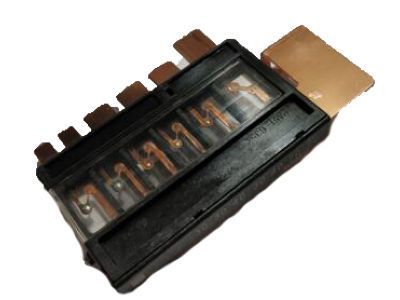

My daughter's FIT is having some serious electrical issues. The sensor for the fob, the LCD display, power locks, camera, etc are not working, and I'm hoping it's the main fuse. I have located it under the driver's side, but cannot figure out how to remove it. I removed the one screw, but it feels like something will break if I pry it down. Please help! Thanks in advance!

IG MAIN should have multiple tabs like a "6" legged instead of "2" legged fuse. Pry slowly.
Ed: probably this thing
https://www.hondapartsnow.com/genuin...3-t5a-j41.html
