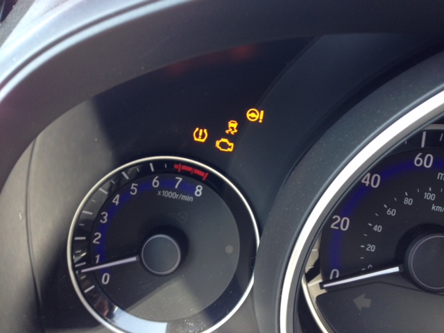

Got a 2015 M/T with 7k miles on it. About a month ago, I started it up and these dash lights came on, with the tire pressure light blinking:
After checking all tire pressures and making sure I wasn't out of oil or missing a belt, I kept driving and nothing seemed wrong with it. Took it to the dealer and the only code was Cylinder 3 Misfire, which they blamed on bad gas. They cleared it and sent me on my way.
Yesterday, after filling up from a different gas station, it happened again. I bought my own OBD2 reader and saw the same code about Cylinder 3 misfire. The car is back at the dealer now, has anyone had this happen?

"Bad gas" is a dealer excuse to get you back out the door and perhaps to another dealer for the ultimate repair. They don't like warranty work as they get paid less for that.
If it were truly bad gas you'd be getting a misfire on multiple cylinders. Since the cylinder 3 misfire recurs it is a matter of looking at things that are unique to cylinder 3, which narrows it to the spark plug, coil, and injector.
Dirty gas would clog the filter, not affect a single downstream injector. Water or other liquid impurities would affect multiple cylinders.
It is likely that the dealer will do the cheapest and easiest thing, replace the spark plug. If the problem recurs they will replace the coil, and if it recurs again the injector.
If I were diagnosing the problem I would replace the plug and swap the coil to another cylinder. If the problem didn't recur it was the plug, if it recurred on the cylinder that got the coil the coil is the problem and if it recurred on the same cylinder it is likely the injector.

GeorgeL, thanks for that quality info. The dealer called me and said they are working with Honda to get to the cause, and the next step is to do a valve adjustment when its stone cold so they need to keep the car overnight I did talk the service advisor down the path of 'so what was the error code last time? and what was it this time? why not try swapping coilpacks to see if the code follows?' He claimed the coilpack was replaced last time and I laughed a little bit before informing him that no, his techs did nothing last time. Sigh.

Why should a misfire produce a TPMS, steering failure, and traction control light?
With that bizarre combination of lights I'd suspect that something in the ECU is screwed up.

Update: Dealer said that the next step is to overnight 4 new fuel injectors to see if that fixes it. That means I won't have the car back until thursday at the earliest. I still haven't got answers to any of my questions from the service writer which is the most frustrating part. I asked about coilpacks and spark plugs again and was told they all tested fine so they ruled them out. I also asked about swapping fuel injectors around instead of replacing all of them and was told that's what Honda instructed
If the fuel injectors don't fix it, I'm told the next step is to replace the entire cylinder head

4 new fuel injectors did not fix the problem, so they are conferring with Honda engineers about next steps and possible head replacement. I'll be at 10 days of repairs next week, 20 more to go for lemon law

Omg. Thank you for posting this. I've had my car for 6 months now, 16k miles without any problems. This morning I got those same 4 lights show up when I started the car up. I thought I would drive the car to the dealership but car would not go over 10 mph. Luckily, got back in my driveway. Called Honda Roadside and they took it to the dealer. Dealer told me they did a software update and it was fixed. I picked it up and a few miles down the road on I-285 here in Atlanta, the lights came back on and power was killed to 10 mph. I almost had a heart attack but managed to get over to emergency lane. An hour and a half waiting on interstate on a shaking bridge, the second tow truck of the day showed up to take back to dealership.
Weird that it is killing my ability to drive it but not you. Good grief. Love that little car but I am going to be on edge with it from now on.

I'm at 18k miles. Exact same thing is happening to me. All the lights just lit up as I was pulling out of my driveway. It's going into the shop when everyone wakes up this AM.

I drive to Sandy Springs daily, but I live further north. Dealer says the code is "Cylinder 3 misfire". He's going to consult with Honda engineers as well. Says he'll have to keep it overnight, and at least some of tomorrow.
Cwapface, did your issue ever get resolved?
@laura Your issue doesn't sound like a throttle body issue to me, almost like it's a plugged exhaust, which USUALLY only happens if your gas runs rich and gets into your muffler/catalytic converter and blocks the exhaust from escaping. With your shaky bridge/285 comment, sounds like you got caught on the northern perimeter on that bridge that crosses the chattahoochee. That's a scary spot, especially if it's rush hour.
I'd also like to point out that my car started idling slightly rougher than normal about a month ago. Noticeable in the morning, but once the car warmed up it mostly went away. If I was stopped at a red light, and the engine was warm, it would hiccup occasionally, but nothing serious.
I'm guessing this is a symptom of our cylinder issues.
