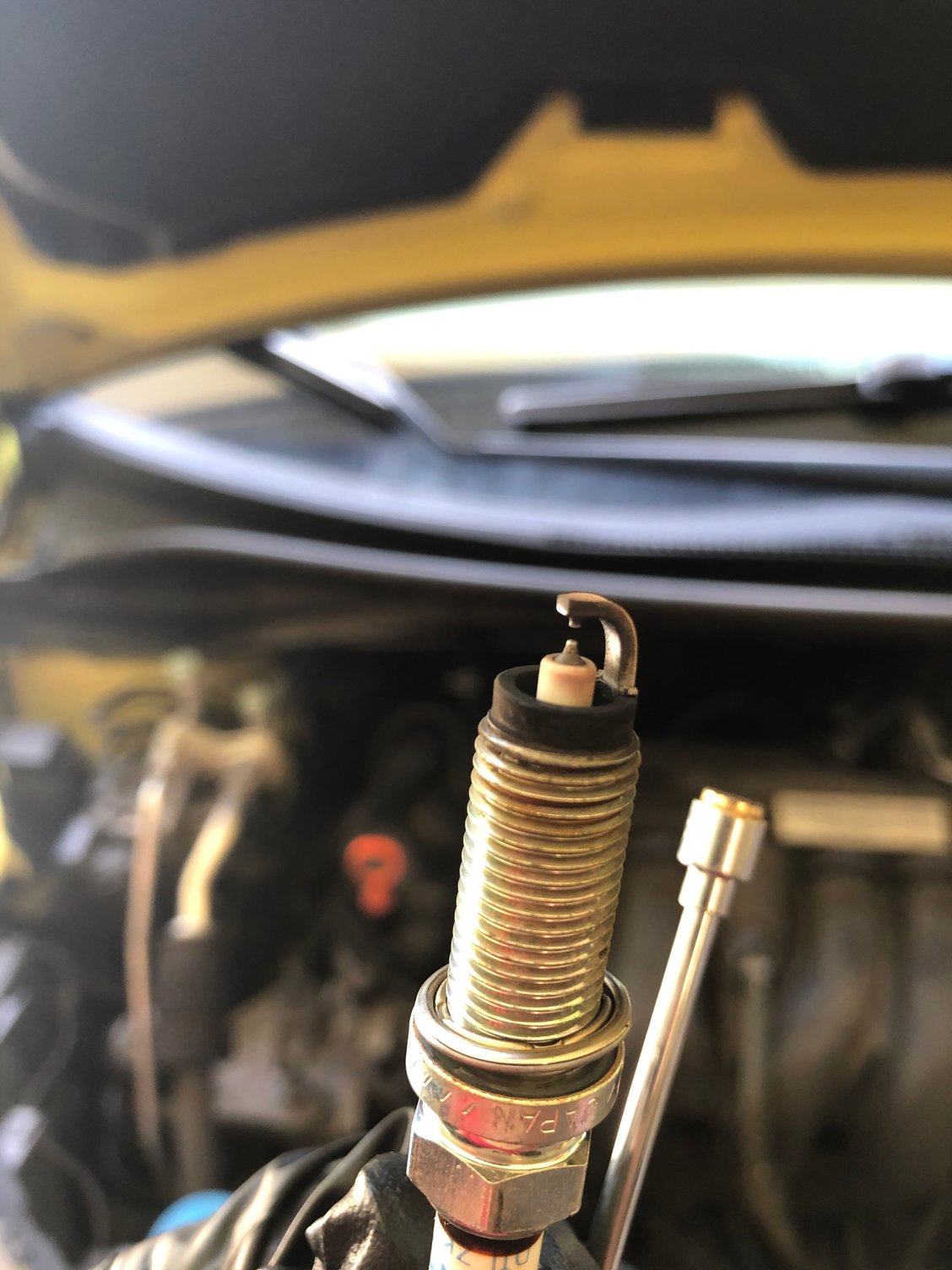

adding some more info here to help anyone else wanting to inspect their spark plugs.
I went ahead and put it back in. Couldn’t really find a maintenance schedule I had confidence in. Not sure what to make of the Honda maintenance system. Based on the chart I’m assuming it will request the C interval of maintenance to change the plugs at 105k?Spark plug model I pulled out. Car purchased new in 2016.
ZKAR7C11S

thanks for the socket size. Used similar tools to check on the plugs for a 2016 Fit with 57k miles. Plugs seem fine pictured below. I will recheck at 10k intervals to see when they really start looking foul.
as for the tools and extensions needed to do this one trick is to tape the socket extensions needed so none get disconnected when removing the plug. Also adding some electrical tape to the inside of the size 14 socket will give you more grip on the plug it’s self for removal or insertion. Magnet tool also comes handy.
