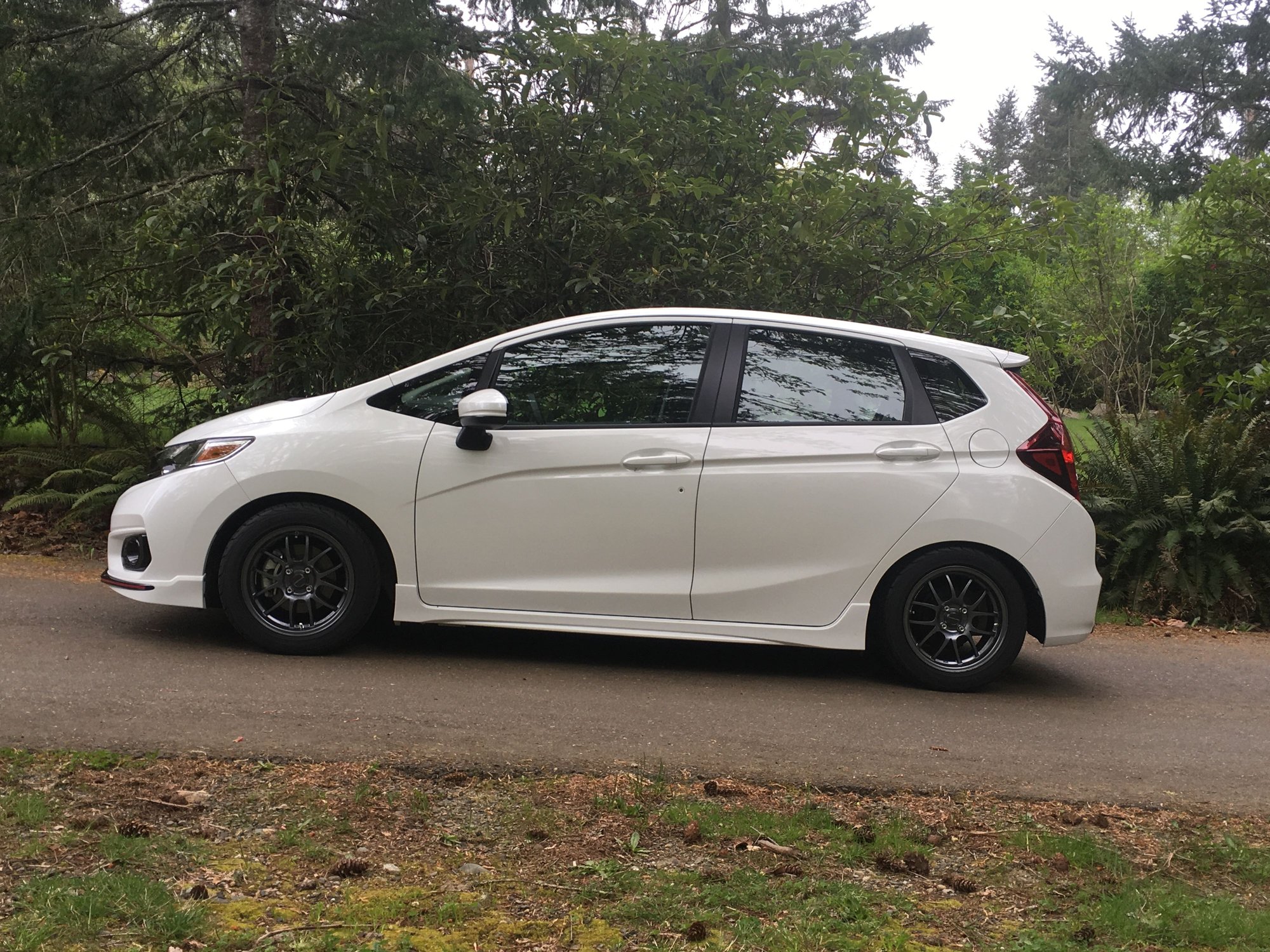

4/27/18 518mi
Lowered with Tanabe springs on stock struts for now. I’m still considering coil overs or Koni struts.

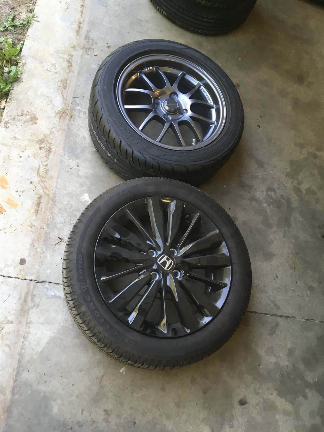

15x7 949Racing beryllium 6UL wheels shod in 205/50/15 Yokohama S-Drive tires.

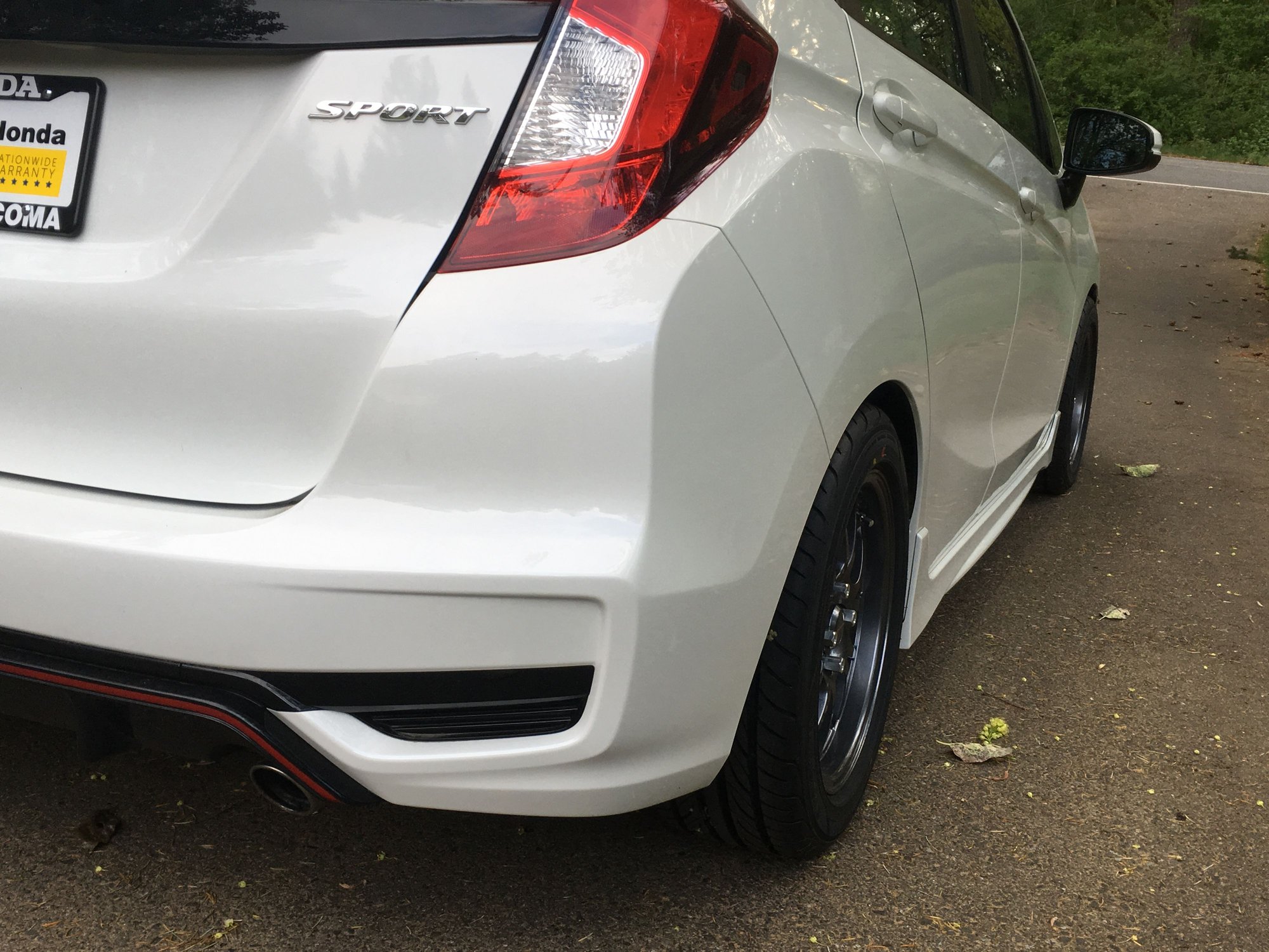

Well, the rear is a bit droopy for my liking. I feel like Tenabe got the length wrong. I’m not sure if I’ll keep these springs or switch to something else.

Nice car and great pics!
Have to agree about the rear ride height. At least in the picture, it looks a bit low in the rear or not low enough in the front.

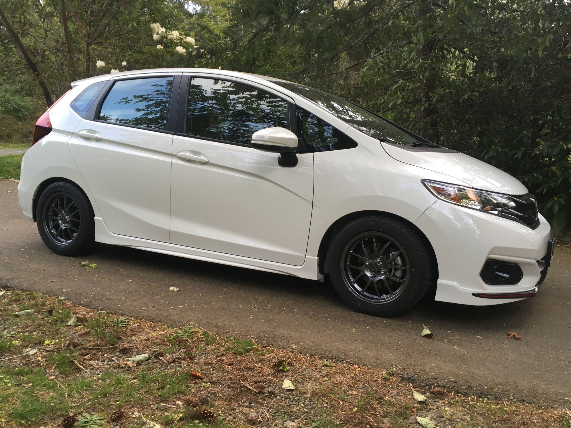

4/28/18
After looking at my droopy butt rocket ship for half a day and thinking about it all night I came up with a simple solution.
Upper rear spring locating boss
Machined aluminum 19mm spring spacers
Spring spacers installed
The spacers locate tightly over the original pin
I’m stoked now! I feel like the ride height is perfect with the 19mm spacers

Much better!!!
Great job on the spacers. Did you make those yourself?

Thanks! Yes, I machined them out of scrap aluminum.
