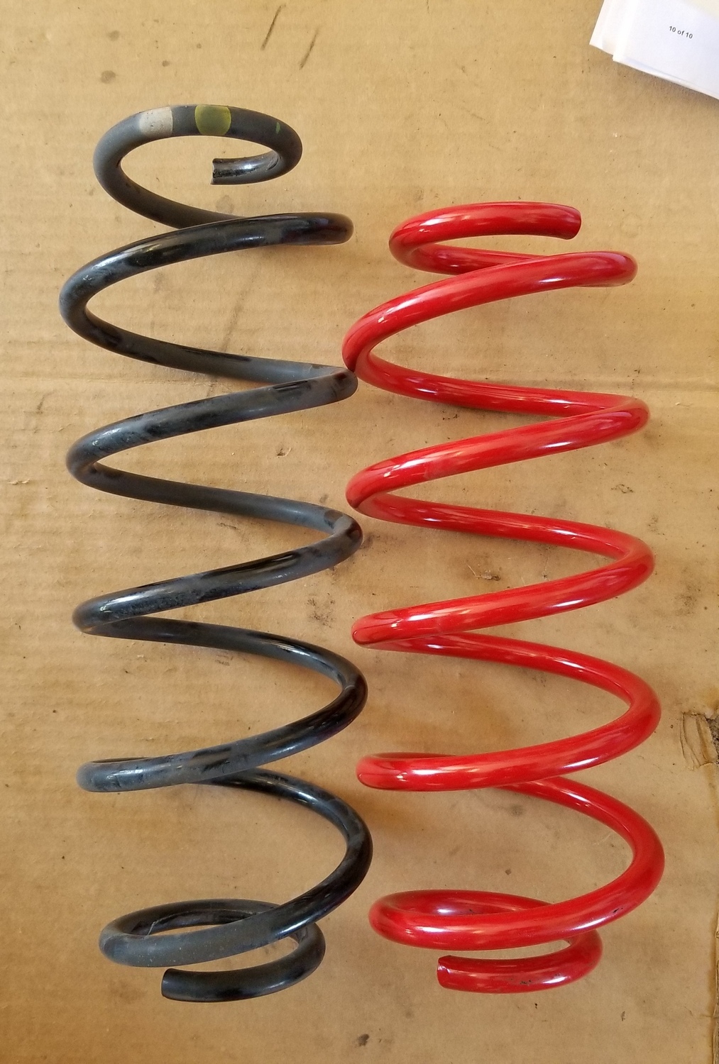

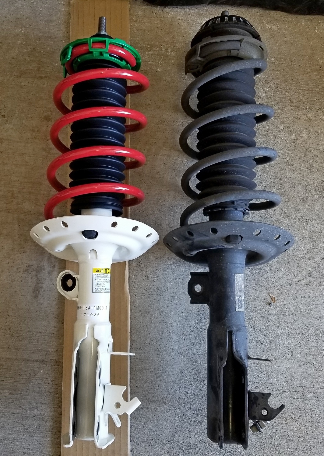

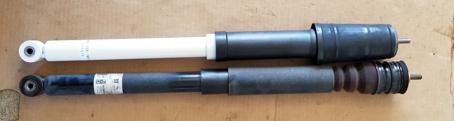

Finally installed it
Been busy lately, and kept pushing the install, but finally got the HFP kit on the Fit.
Install was pretty straightforward.
Couple things to note were to remember to keep the front spindle in position with a rope/strap so the driveshaft won't pop out, and also to tighten the bolts down with while jacking up the suspension with the floor jack.
Finally those top nuts on the front struts were a PITA to get off lol.
Here are some pics of the HFP suspension. The shocks are a little shorter so they will operate at the proper height.
The drop is a modest 10mm, but my aim was not to slam the car while respecting the original suspension geometry, so this is perfect.
There is enough ground clearance and stroke for city driving.
The ride is a bit stiff now, but nothing that kills my back, and body roll is minimized.
Very satisfied
Need to work on wheels next.
