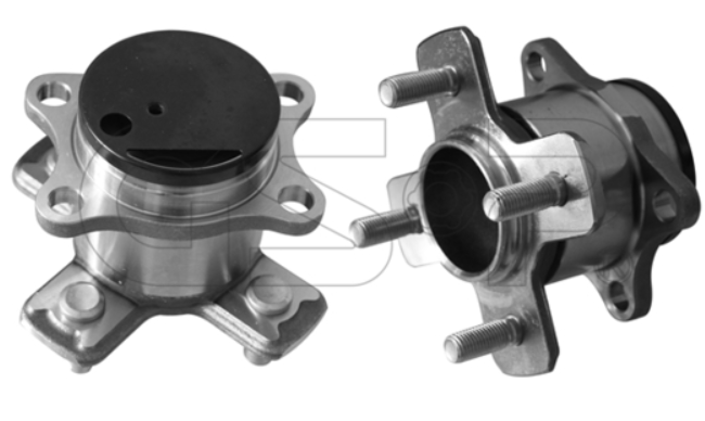

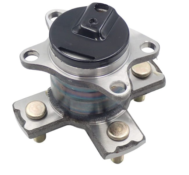

I found out that the hub bearing assembly is identical to the drum and disc model (RS in Japan).

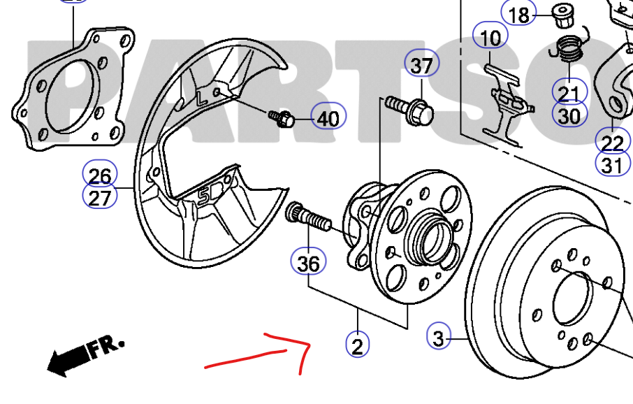

RS version | parts number: 42200-T5B-N51

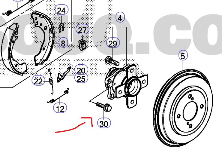

However, the picture isn't the same as on the diagram but it matches the parts number.
Drum Brake Version | parts number: 42200-TY0-951
The only difference I can see in the picture is where the speed sensor mounts and If all are the same, I think it might work almost plug-and-play without much modification.

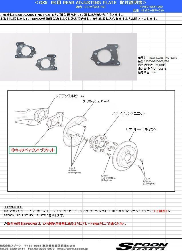

Just something to add you can likely go straight to a rear camber plate setup instead of buying the oem rear brackets. Cusco and spoon make them off the top of my head.
