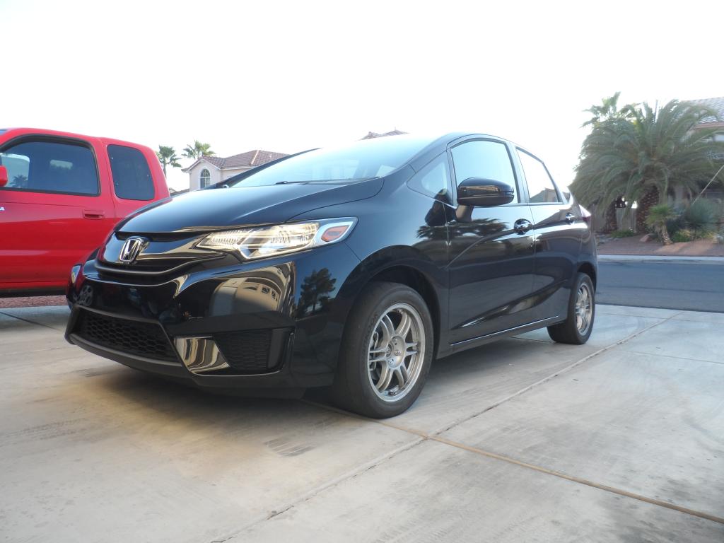

i already posted this picture elsewhere on the forum, but here it is again.
those are Kosei K1-TS wheels in 15 x 7, with a 38mm offset. the tires are 225-45-15 Hankook RS-3 that are one of the sets from my STC class 89 civic Si race car.
these are not the wheels that are going on the Fit though... you can read why i put them on in the newbies section.
but, i did compress the suspension by using a floor jack under the lower control arm 2.5 inches, and then turned the steering wheel back and forth lock to lock. plenty of clearance with no rubbing, and clearance for suspension compression when bumps are hit on the road while cornering.
you could go wider... but probably not a good idea.
just make sure you get the correct offset wheels. if you lower, and then have 45mm offset and have tires that wide, you may be close on clearance on the inside. if 35mm, you may have clearance issues on the fenders. i would suggest 38mm to 42mm for a 7 inch wide wheel. those should be fine even if you want 16 or even 17 inch wheels, if you are keeping the approx outside tire diameter of the stock tire. you will have plenty of clearance.
note: i would suggest not going too big on wheel diameter, as it will hurt performance, and our cars are already pretty weak. and it seems that a 205mm section width tire would be about optimum for the car. i would not suggest the 225's like i have unless you are doing corner track racing only with them. it did tend to wander all over the road with tires that wide.
bottom line, the wheel wells on these are huge. there are a lot of options that will fit with plenty of clearance.

those tires don't look like RS-3's though. more like the slicks. I'm just happy that spec miata tires fit too.

they are RS-3's that are half worn. about where they grip the best at. that set is the ones that i just took off the STC car. i have a couple of sets along with a set of Toyo R1R's.
ahhh... you saw my pic of the Spec Miata tires. that is actually a set of un-mounted ones, with the plastic Fit LX hub cap set in there... no actual wheel. i just thought it looked cool... stock LX with R-Compounds. so i took a pic.
