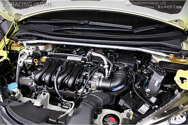

BTW: Looking on J's Racing Japan site, they have a strut tower bar that doesn't seem to be directly linked/connected to the strut towers itself. It is...somewhat.

I thought the strut towers are actually tucked closer to the firewall and hidden by a plastic piece. You can see in these threads where a mouse made quite the nest:
https://www.fitfreak.net/forums/3rd-...ware-mice.html
https://www.fitfreak.net/forums/3rd-...2061-mice.html
I think that's where the front strut bar mounts
