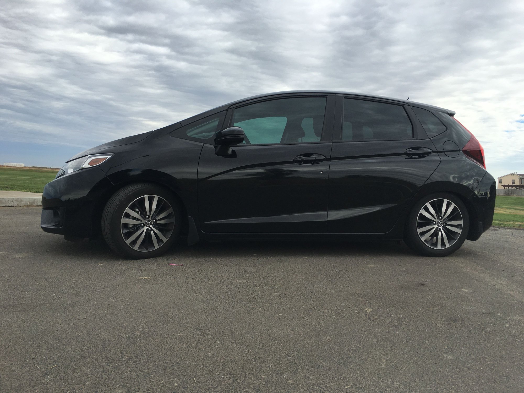

I have RS-R "Down" springs on mine - wanted a minimal drop due to our ill-maintained roads here in Illinois. I actually rub the fenders less now due to the higher spring rate.

Looks great. By how much do those springs lower the car because it seems to be very minimal?

I have these springs too. Love them.
Honda Fit With GK5 Chassis Code 2015, Down™ Front and Rear Lowering Coil Spring Kit with 0.2" Front and 0.6" Rear Drop Height by RS-R®.

so the rsr really level the car instead of lower it. That's nice.
