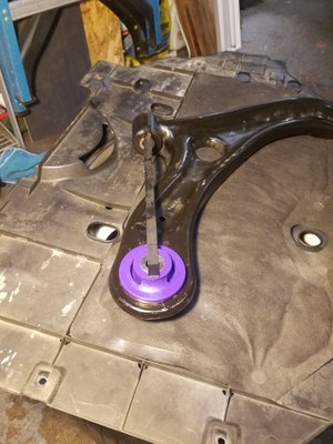

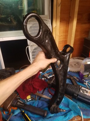

Here's the LCA removed from the car. Now its time to remove the stock bushings. For the front (smaller) one, I used a razor to cut off one side flush with the cup its in. Then I heated the metal inner sleeve with a torch until I could pound it out. This one is all rubber so it's pretty easy.
Here's the new outer sleeve on top of the stock one for comparison. Perfect match.
Now here's where you need to get surgical. Get a sawzall blade through this slot and carefully, a little at a time rock it back and forth until the outer sleeve is almost cut through, then break it with a hammer and chisel or punch. You can do this again on the opposite side and knock it out with a hammer.
Heres your LCA with the bushings removed. Clean up the bores for the bushings with some brake cleaner and pop the new ones in. The small ones fit easily by hand, but I'd recommend using a shop press for the ring of the large ones.
LCA with new bushings fitted.
Make sure the slots in the bushing are aligned according to the instructions.
Heres the whole thing, poly bushings and roll center adjusters!
Reinstall the arm. Push the rear large bushing straight into the subframe from the wheel well. Stick the bolt in, then rotate the arm until you can align the front bolt hole.
Put the arm bolts in almost all the way and reattach the ball joint. Use a jack under the ball joint to push the whole assembly up and load the suspension. Now tighten the 3 bolts to spec and reinstall the cotter pin to the castle nut.

I purchased brand new control arms to minimize down time. Phase 1 is complete.... I've got the bushings off. Huge thanks CodeMan for the tip of sawing through the metal ring, using a press was useless for us
Smaller bushings were much more simple to remove
NOW .... just camping around for the next ebay coupon, and I'll make the purchase on those bushings.
