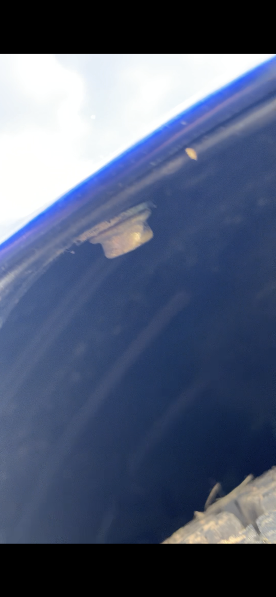

I bought a set of snow tires for cheap on steel rims. They are 185 65 15 and being so close to the OE 185 60 15 I thought it would be fine. I put them on and all seemed fine until I hit my first real bump.
The tires are rubbing somewhere... the only spot that looks like it may have been hit is the little metal retainer inside the wheel well.
Has anyone else "upsized" their tires and found where it is rubbing. This tire should only be .8" bigger so only .4" closer to the wheel well. I think it only rubs on the drivers side front tire.

Well there is the reason for rubbing. It is not about the tire size, it is about the offset too far away from the original and it brings the wheel outer than stock. My advise would be to get suitable rims e.g. used Fit rims and keep the tires you've got.

I agree that the offset is the problem. 65 ratio tires shouldn't rub; might be close but shouldn't. Be careful driving with those mods. Stock offset on mine is 53, when I decide to get new wheels I'll be sticking to 43-53. You could move to a place where you don't need snow tires.

I think the offset is the primary culprit it puts the edge of the tread just under that little metal nub in the tire well and that’s where its hitting. It is probably barely touching it since it hasn’t ripped it out.
