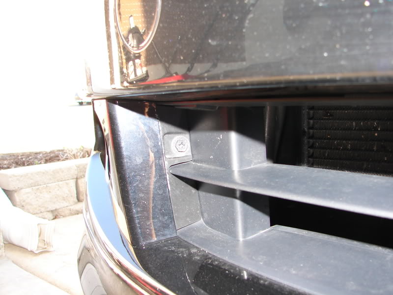

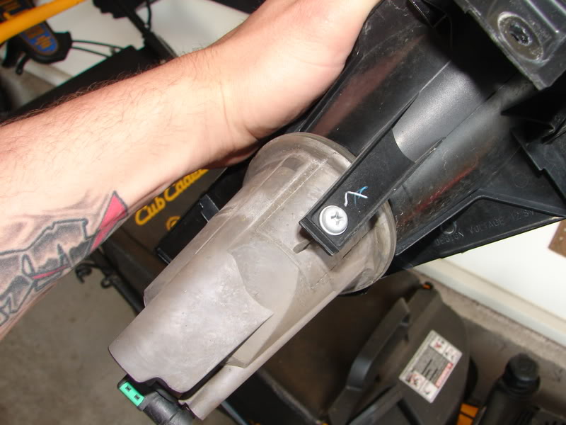

So i did this on my 180 a few years ago and im not a huge fan of lamin x so i glass stained my fogs and it was cake ! you can buy it at michaels its krylon glass stain yellow. its about 8 dollars a can one can is moooooore than enough !!!
first to get them out its only one screw located here....................

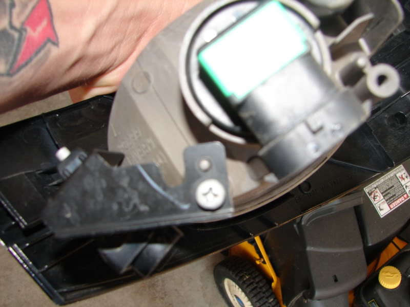

than you need to un plug the bulb which is kind of a pain in the ass because the wire isnt very long. i found its easier to leave it in and just unclip the harness by squeezing the sides and pulling it down.....
now theres two screws holding the lamp on located here and hereName:  DSC01233.jpg
and ,

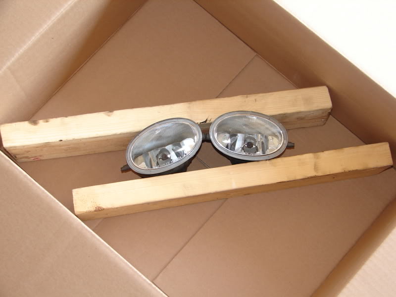

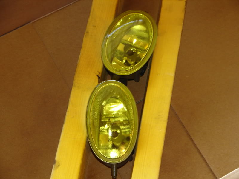

lastly create some sort of painting booth better than this HAHAHAHAHA !!! clean your lens well use rubbing alch. and than 3 to 5 light and i mean light coats or you will get fish eye and runs ... hold the can 12" away and for those of you who arent aresol wizz's start off the painting surface continue over it and stop after you completley pass the surface... you should end up with this .........................
now i put like seven coats on which ended up not making them any darker and not very smooth but at the fourth or fifth coat they were perfect !!!

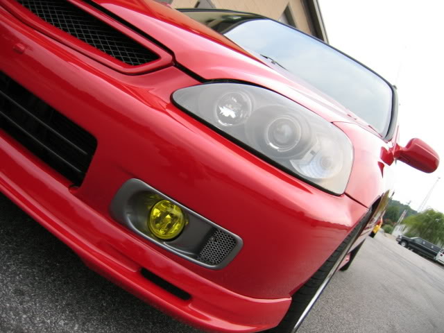

did this on my hatch and i used dupli color metalcast yellow anodized and worked perfectly no fading or burning, the prob was that after about 6 months the rocks chipped alot of the paint off, so just sanding down and repainted works great!!

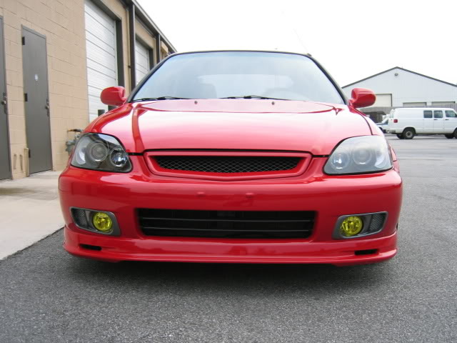

heres some pics of mine:

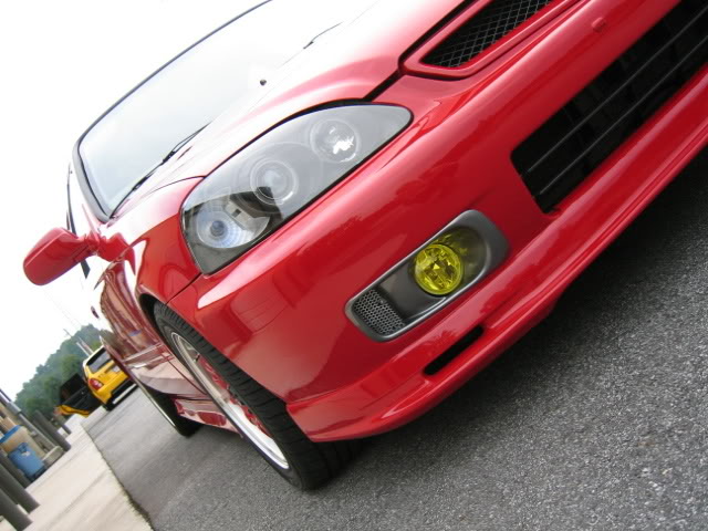

AtticusFit
