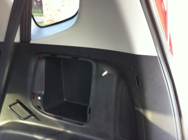

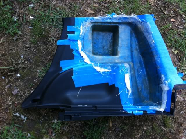

Okey so here we go; first step is to create the fiberglass box. The box will be molded to fit the right side of the cargo area and take advantage of the square cubby in that location. Credit has to be given to member Danger69 who did a very similar box, and was my inspiration.
I removed the plastic molding in that area so I did not have to work with the fiberglass in the car. I'm glad I did as this stuff stinks and makes an absolute mess of anything it touches. Mask of the area to which the fiberglass will be applied an add the first couple of layers of glass/resin:

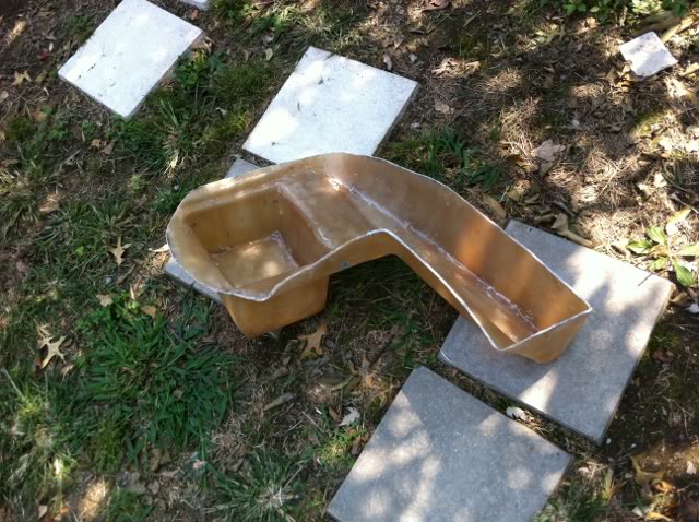

Once that has cured we pop it out and remove as much of the tape as possible:

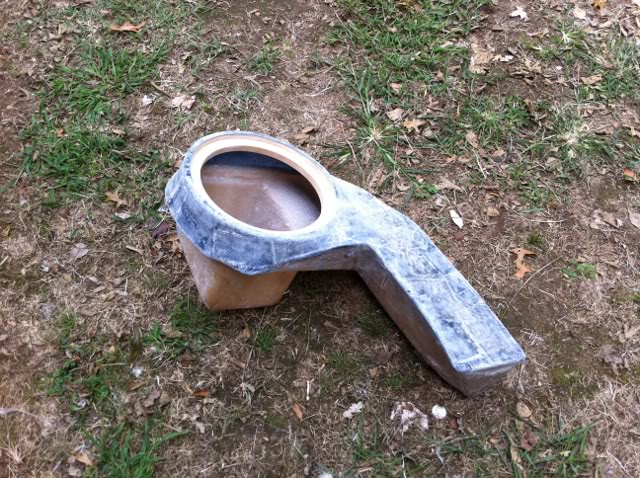

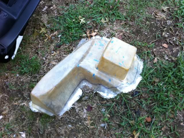

Now I added several more layers of fiberglass and again allowed the piece to cure. Then I cut the edges off using a jig-saw. This is the back side of the enclose and sits pretty much flush with the tire well:

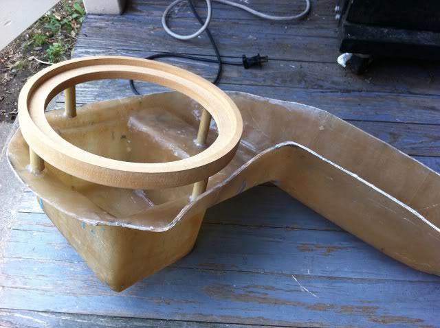

Next we install the mounting ring for the sub. In this case the ring is sunk for a flush look in the end. It is held in place for the time being using dowel rods and hot glue:

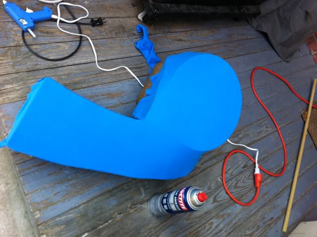

Now I took a piece of a fleece blanket and stretched it over the top of the enclosure, securing the edges using 3M spary glue.

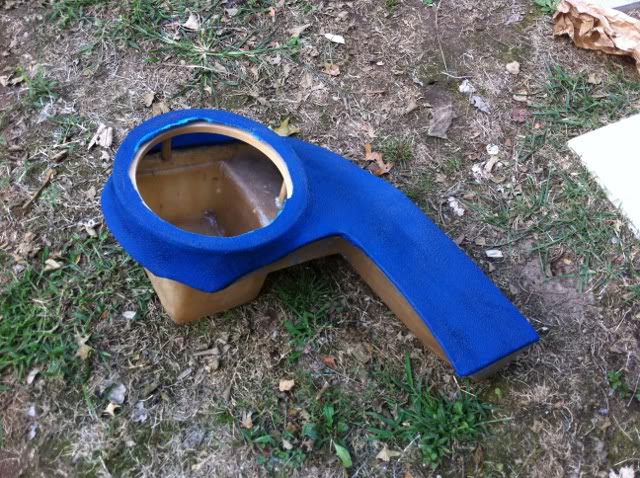

The cloth gets socked in resin and allowed to dry:

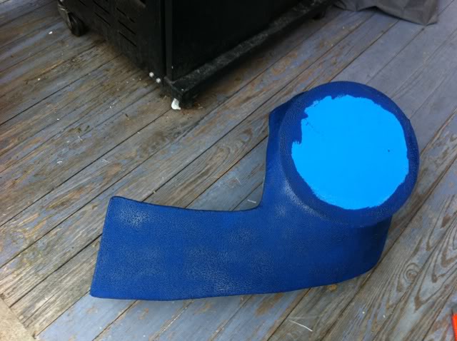

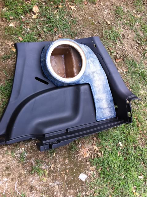

Now I added a few more layers of fiberglass & resin on top of the fleece. Then some sanding:
A quick test fit to make sure everything still lines up:

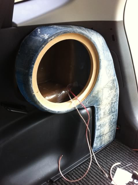

The box will be bolted to the side of the car using rubber washers and a wingnut. Here is the location of the bolt I added:

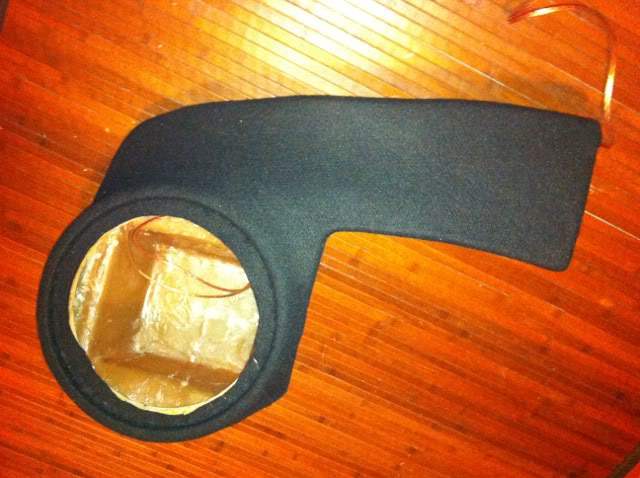

Now its time to add carpeting to the box. I again used the 3M spary glue to secure the material to the front of the enclose.

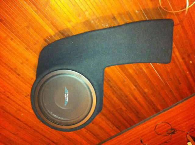

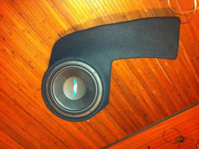

Now the sub:
And the grill:

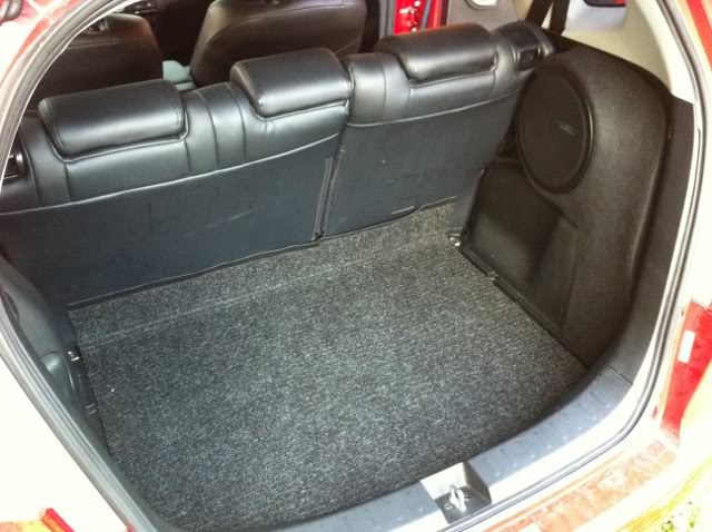

Now lets fit the enclose and sub into the car. Everything fits great. I do loose the ability to lean back the rear right seat (never happens anyway).

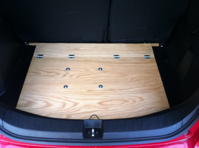

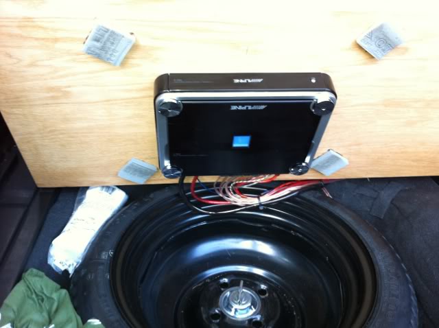

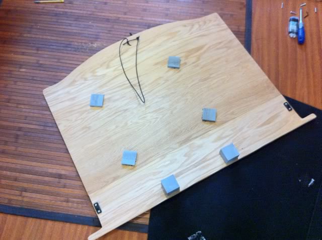

Okey now its time to mount the amp. As I mentioned the PDX5 will sit inside the spare tire. I decided to replace the dinky rear floor with a solid wood substitute. The amp will be mounted upside down to this and basically hang in the center of the spare tire.
Pics:

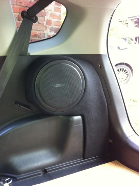

Now here is the final result with the carpeting returned to the trunk area :
So, how does everything sound? Incredible! I'm really impressed with the PDX5. Its a truly tiny amp but the birthsheet puts it at 108wrms x4 + 402wrms x1. More than enough power for the speakers and sub. I was worried the class D couldn't compete with an A/B, but this sounds better than the JL 300/4 I had in there before. The IDQ10v2 is also doing great; simply a fantastic SQ sub. Very tight, accurate bass. Not an SPL monster but more that enough output inside the fit. Does great with all kinds of music. Enclosure ended up with approx .65 cuft of volume.
