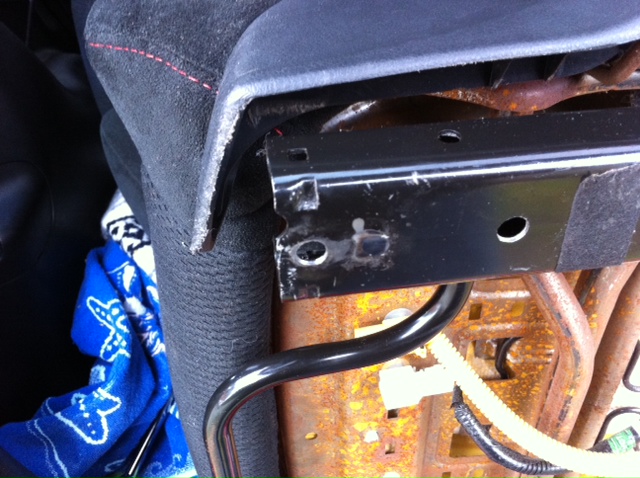

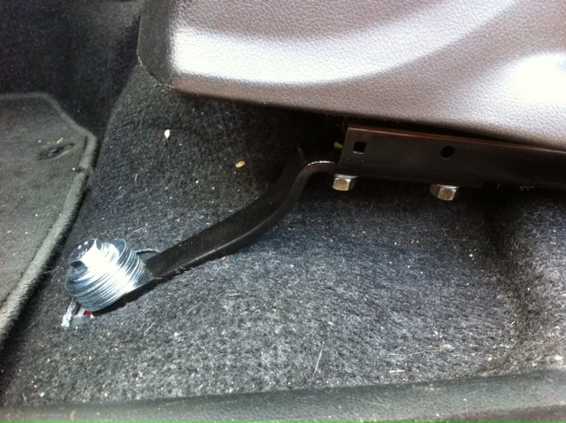

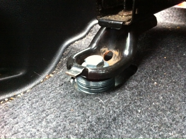

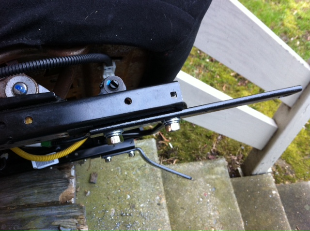

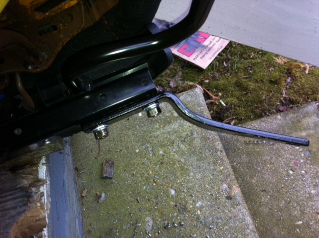

So I got around to installing the driver side Civic Si seat last weekend and though i would share. I braught this up in another thread so will just quote what I already said about the seats and install. To lazy to re-type
Originally Posted by jcuecker
I just finnished installing a 08 Civic SI seat. I still have to do the passanger side this weekend. Everything is plug and play, and all the sensors are there.
The drivers seat feels absolutly wonderfull. Full back and latteral suport. Suprisingly, vibrations and bumps dont transfer as easily through this seat either. The way I have it installed the seat sits just slighly lower than the stock GE8 seat, but is height adjustable. Back seats still fold down fine.
I'll get some pics up a little later.
Yeah, I just measured and it sits 1/2" lower. Not sure how much more or less you sink into the seat but I noticed the height difference as I had to re-adjust my steering wheel slightly to regain my view of the speedo.
As for the rails. Modified stock SI rails. Basicaly the rear feet just about line up, but one side has to have the hole slighly redrilled. The feet are about 3/4" of an inch shorter than the stock ge8 so I took a stack of wide fender washers and 50mm grade 10.9 bolts to raise them up slightly.
For the front I had to chop off the existing feet and remove the rivets. Drill slighly larger holes into the rails and mount custom feet made from 1/4" steel stock. The new feet where bolted to the rails using high tensile bolts, compression washers, and nuts. Should be at least as strong as the OEM rivets, but if your paranoid you could get them welded instead. One thing that you will notice is that the OEM rear feet are attached using much larger rivets. This is becouse in most accidents (front end) these are the ones that do most of the work of holding the seat to the frame while front feet act more like pivot points.
I swapped the seat buckles (direct swap). All the sensors (weight position, airbag, etc) plug in and work work fine (i.e no dash light).
BTW; im 6'1"/190 and I've got like 4-5" of clearance above my head.
That 1/2" actually feels like more. I can't go any lower using this method. The right rail is basicaly resting on the floor as is the lever to adjust the seat position.
BTW im not sure I can do the passanger seat the same way because of all the extra sensors and crap in the rails. Not enough room to get bolts in there. So I'll probably have to make brackets that attach to the existing feet and then the floor. It'll prob sit 1/2" higher than stock. I don't care that much about the passanger side though.
PICS:

*disregard the washers on top. that bolt was just too long.

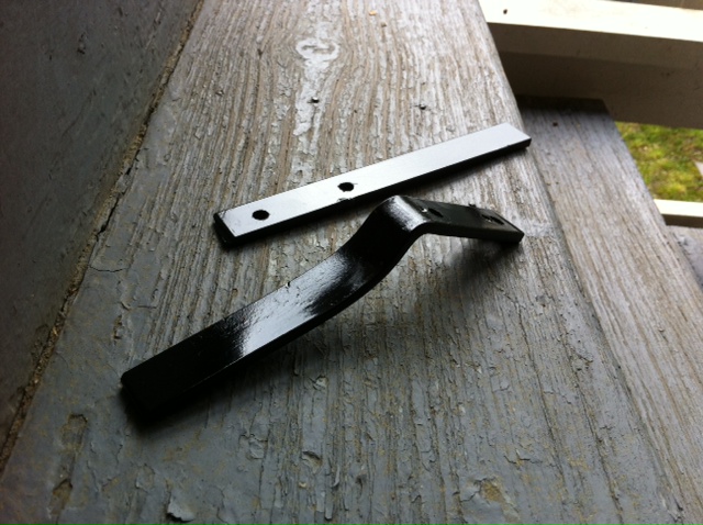

Did you just heat some plate steel and bend it to make those front mounts?

Yeah, to fabricate the brackets I just mounted the steel stock in a heavy vice, heated with a torch, and pounded it with a large mallet. Dont drill the main monting holes untill you have mounted them too the rails ant did a test fit.
I found the steel stock at work but you could probably find something similar at Lowes/HD. Or Mcmaster has 1/4" (3/16" would prob do fine too) x 1" bars in 6ft pieces:
McMaster-Carr
I probably lifted the seat SI and OEM seat in and out of my car at least a dozen times, and to be honest could not feel a difference in weight. Very simialar if I had to guess.

I would love to do this but it doesn't exactly look safe. I don't want to find out the hard way if you know what I mean.

Im not very worried. All the OEM safety features are there. I know the brackets I made are stronger than the OEM feet. I also think the bolts holding the the brackets to the rails are at least as strong as the smaller rivets. That being said once eveything is in place welding these would prob cost $50-75.

It looks more robust than the stock mount. Those stamped sheet metal stock mounts are very flimsy. If you use grade 8 (I would probably go 10.9+ just to be safe) or higher hardware, the setup looks very strong.
The only improvement I could see is fabricating a solid riser in the rear with tight tollerance to the bolt, rather than using a stack of washers. It would reduce the horizontal force on the taller bolt in a high impact crash and reduce the chance of that bolt shearing.
Or you could fab a small riser bracket similar to the front. Probably couldn't bend it that tight, but it could be welded.
