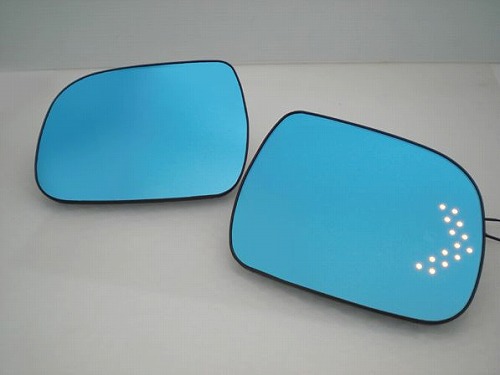

You should get these:
GARUDA LED
They're wide angle, blue tint (to reduce glare), have the turn signal on the glass, and they're HEATED... Alpina found them, gonna order me a set as soon as I can.
GARUDA LED
Those are pretty cool!!.. If I lived somewhere where I would need heated mirrors I will look into that instead of doing the $5 led arrow mod. Do you happen to know how much shipping cost are for those?
$105 + what is the shipping cost?
