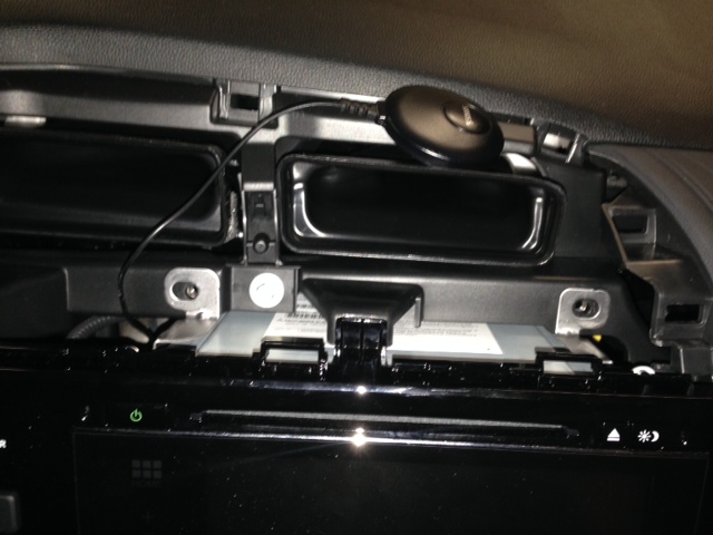

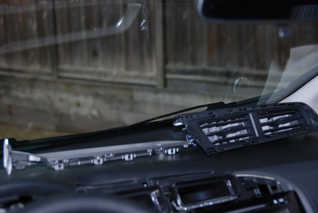

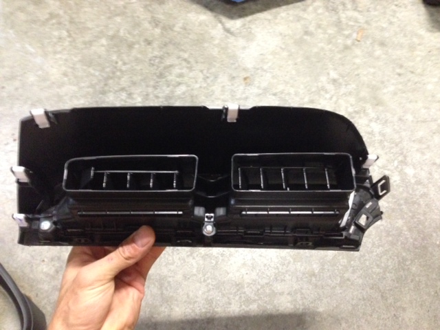

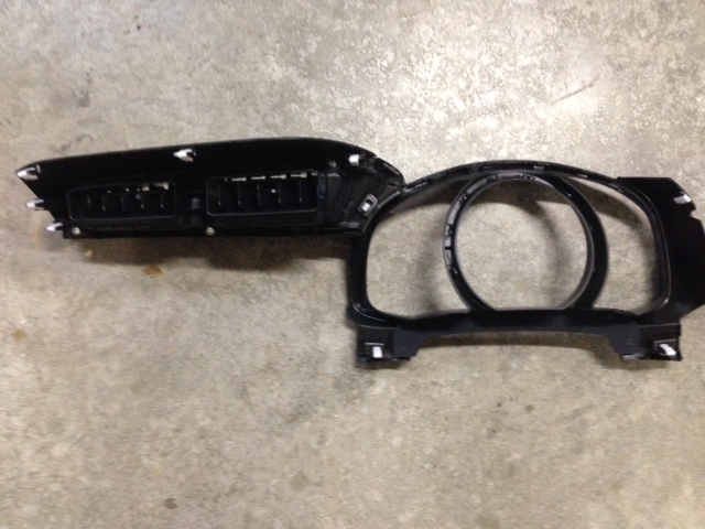

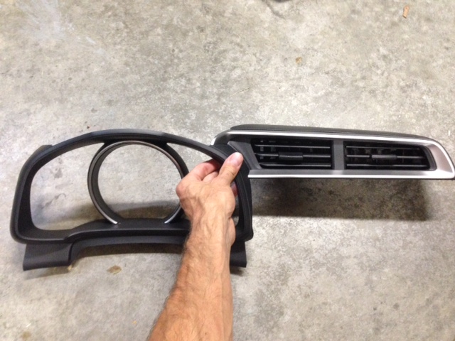

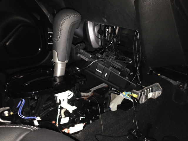

OK, maybe these will help.
This is the lower piece with the aux jacks. There is one screw on the front, not hard to find. Then pull. The rest is clips.

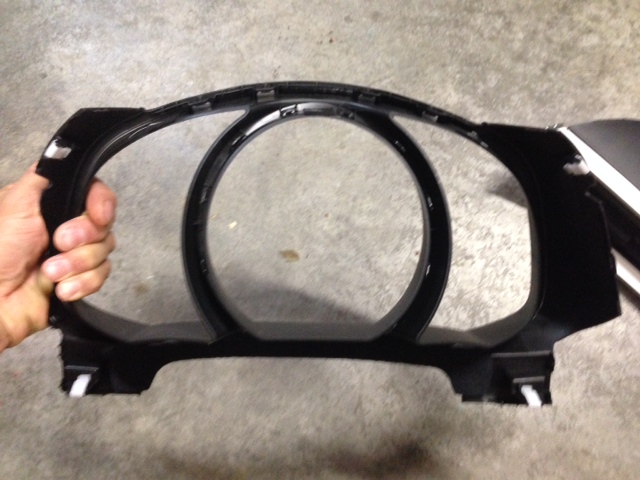

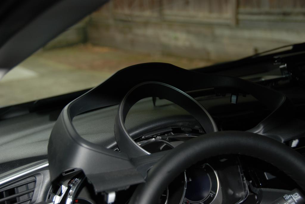

Next remove the gauge trim, then the vent piece above the radio. You have to pull on them. They're only held in with clips but the gauge trim has to come out first.
Then remove the two 8mm bolts on top of the radio.
Finally, one 8mm bolt going up into the radio. It's already removed in the pic but if you remove the glovebox you can see it under the radio.
After that, just grab the top of the radio and pull. It will unclip.

Superfly, helpful as always. The pics posted sez it all!!!
A thousand thanks!!!

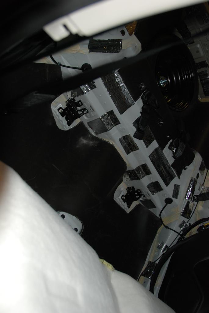

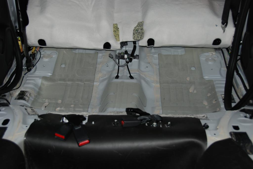

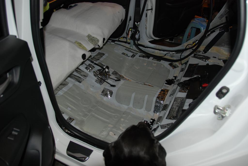

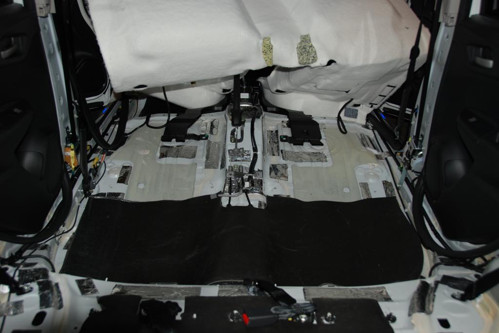

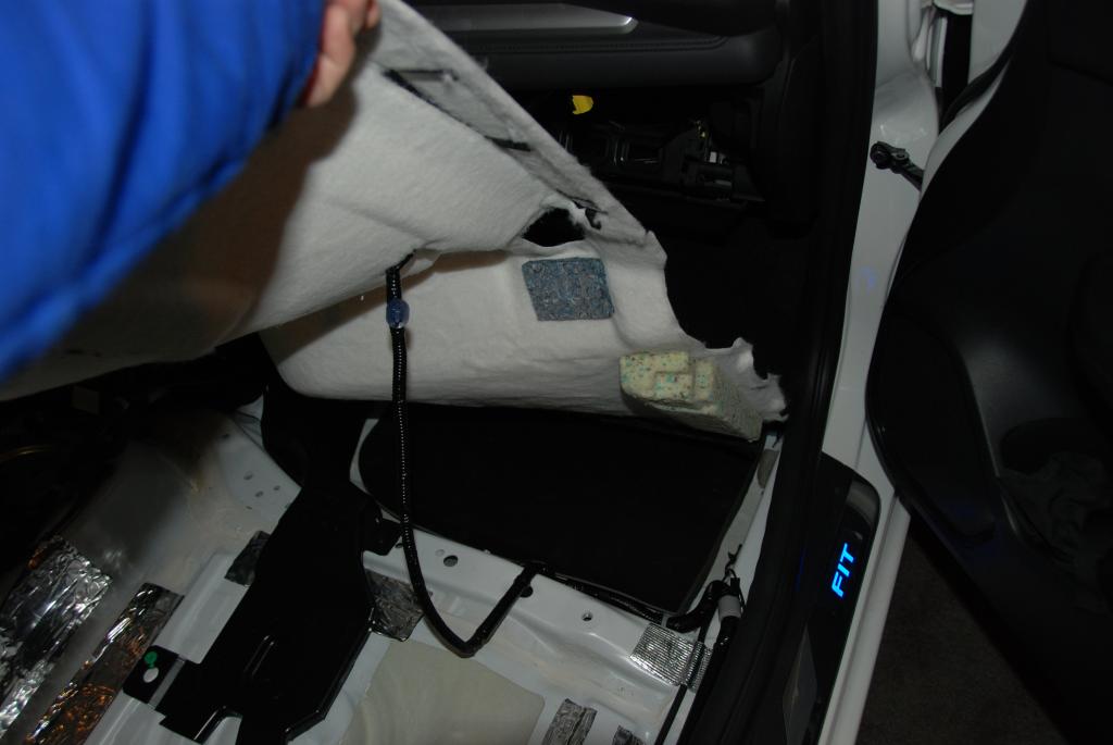

Seats are out and proceeded to install CLD, CCF and MLV in the front and rear floor area.
Factory Sound deadener (no need to overlap these) Rear seat floor
CLD Tiles in Rear floor area
MLV/CCF installed REar seat floor
CLD on Front floor area
MLV/CFF on right front floor

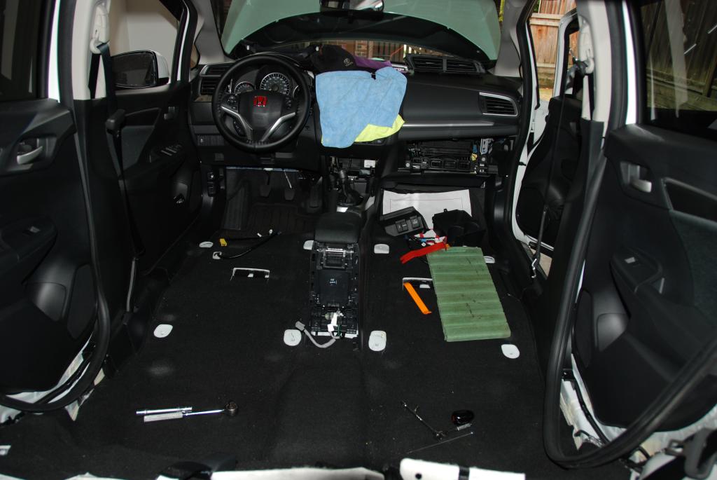

Started wire layout and install
Here's the latest (likewise posted in the What Mods...... thread):

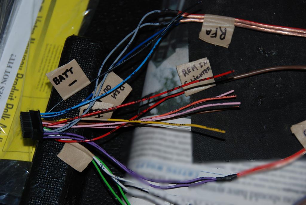

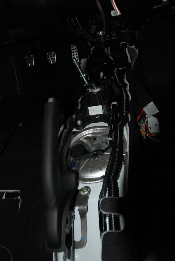

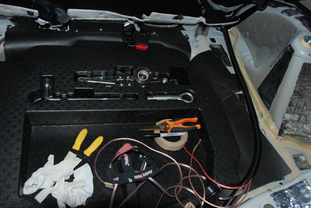

..........started on the wiring from the HU to the spare tire storage area.
HU wires will be connected directly to the OEM speaker connector for both the F & R speaker as well as the tweeters on top of the dash.
Wires in its own harness cover passing through the center console
Wires in harness cover to the spare tire cover

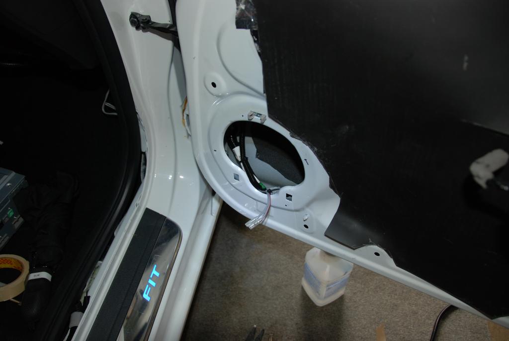

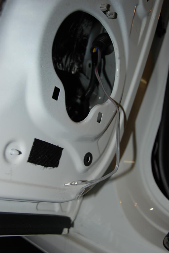

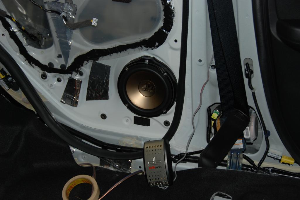

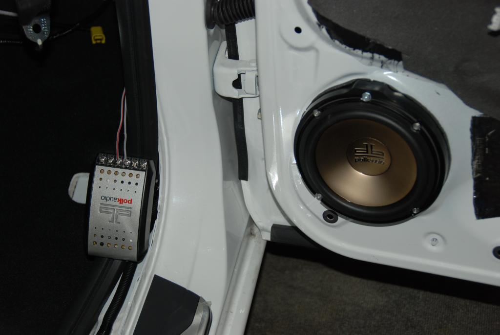

Left rear door wire and speaker install:

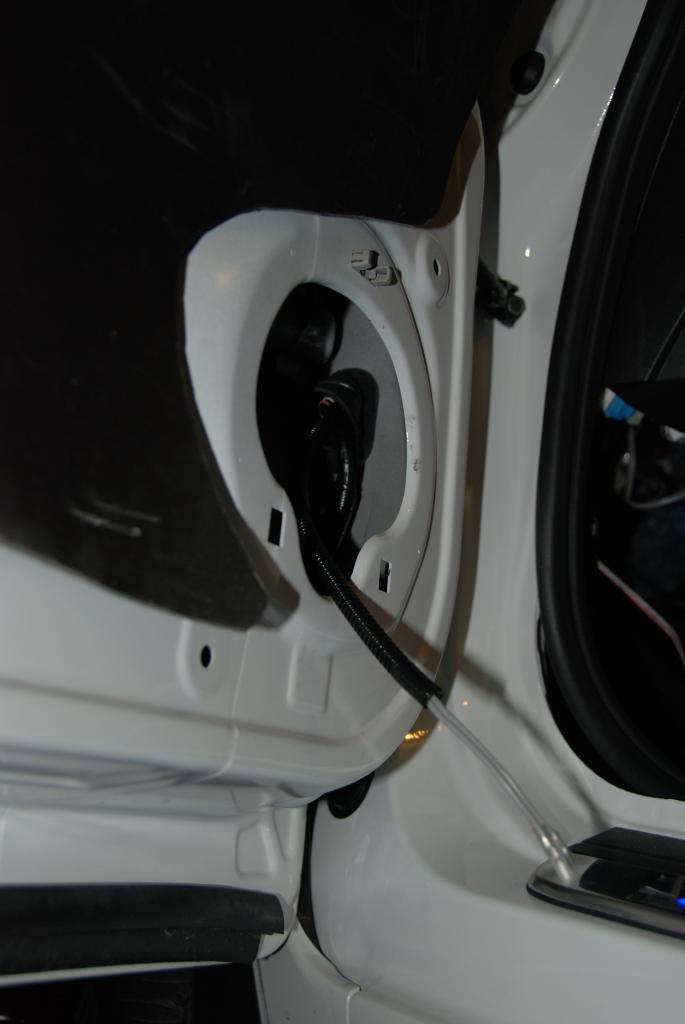

Speaker wire from crossover fished through door grommet

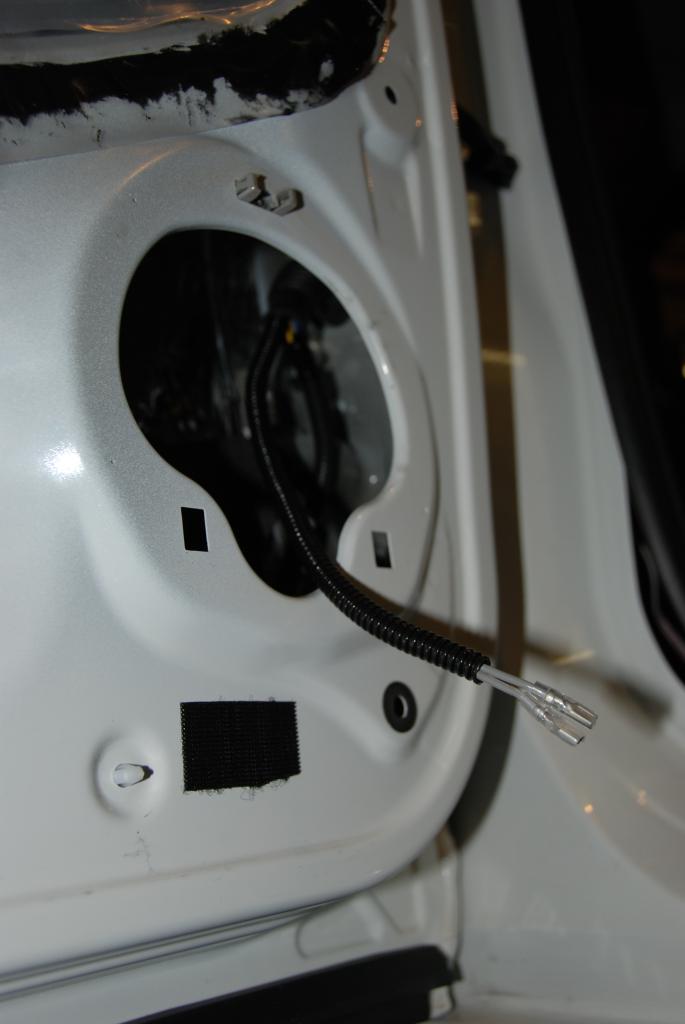

Speaker wire through inner door grommet
Speaker wire loom covered

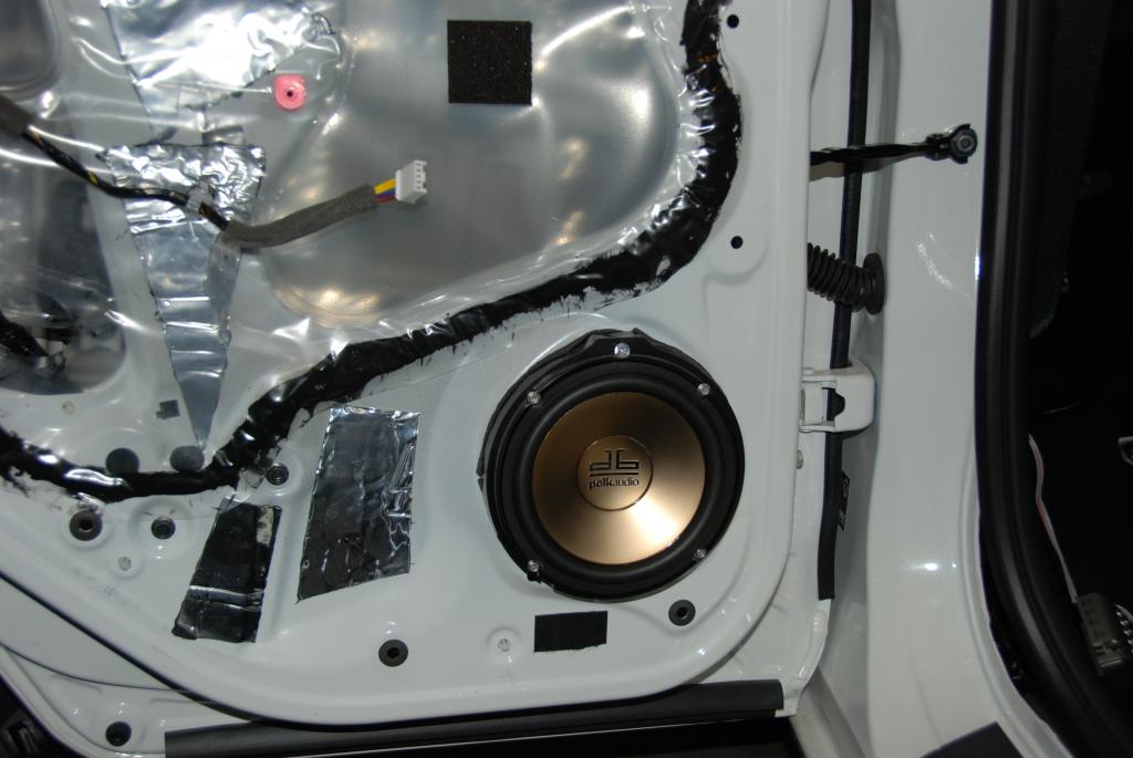

Speaker installed using adaptor brackets.

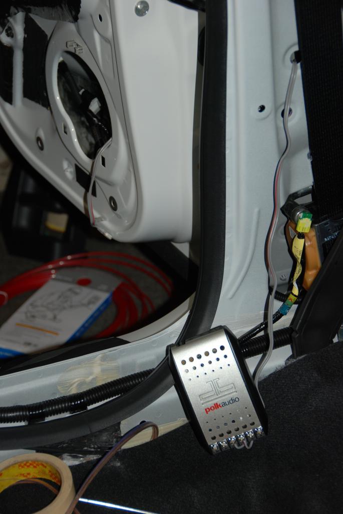

Speaker and crossover wired. Crossover will be installed on the pillar (middle portion) behind the seat belt. There's lotsa space there. Being very light, most probably will use industrial double-sided tape. Am not a fan of drilling when I don't really have too.

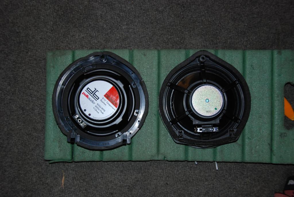

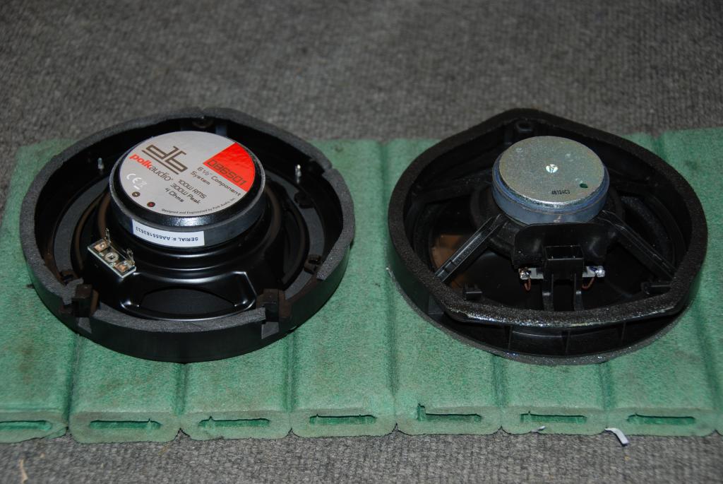

Compare the factory OEM speakers with the mid-range priced Polks. Bigger magnets and twice the weight. Easy to figure out why Honda had to boost equalization from the OEM HU to make those factory tinny speakers sound decent.

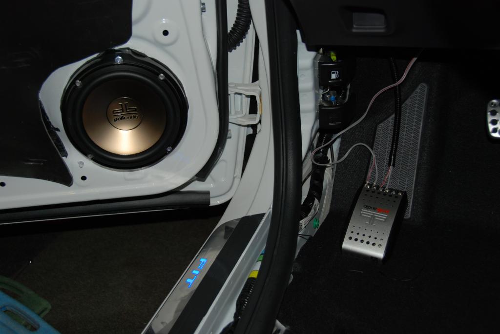

Speaker, tweeter connected to crossover Right front door
Speaker ready for install Left front door
Speaker, tweeter connected to crossover Left Front door

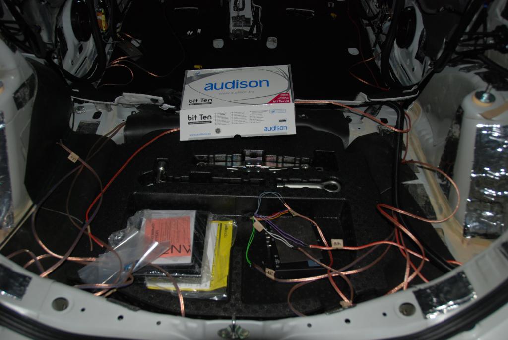

UPDATE: Wires, wires and more wires 10/21

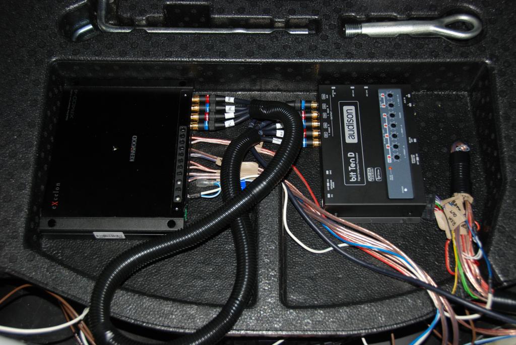

Speaker wires laid out from sound processor and connected to crossovers.
A mess of wires getting ready for hook-up to sound processor (to be mounted on spare tire cover right beside the amp.)
Speaker wires and Remote ON soldered and shrink-wrap connected to sound processor harness.
Tomorrow will mount and wire the power and negative cables from the battery will go to respective blocks to provide "juice" for the processor, amp. and powered sub.
Update: remaining doors done today 10/20:
Finished install of speakers and crossovers on the remaining doors. Feeding through the door-grommet was easy enough except for the front driver's door. On the rubber boot attached to the body, there is a plastic surround base. To add to the difficulty, once past, there is a double wall so fishing the wire was tedious.

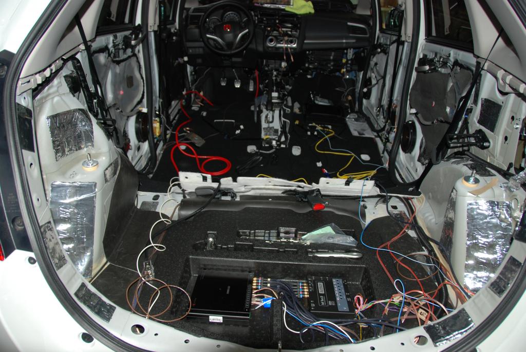

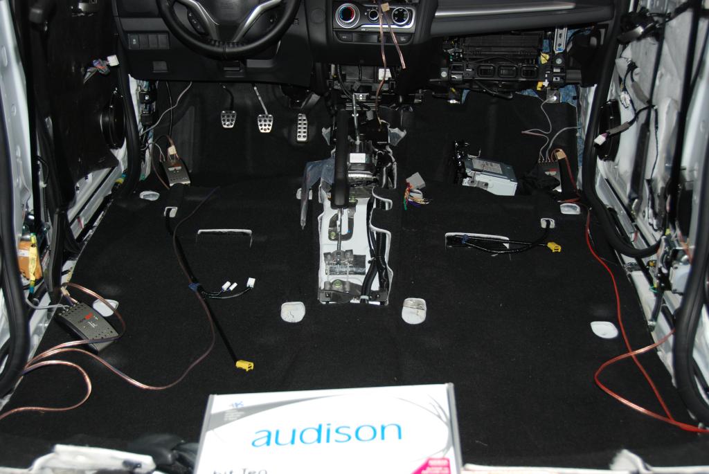

Power and components wired
Wires and components finally laid out

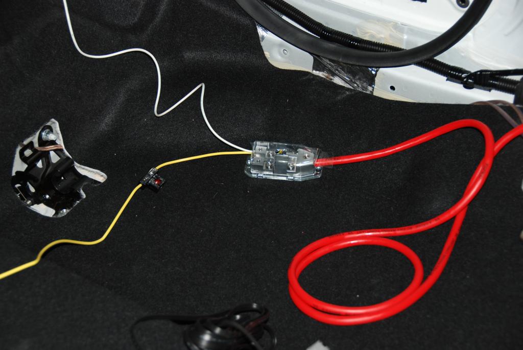

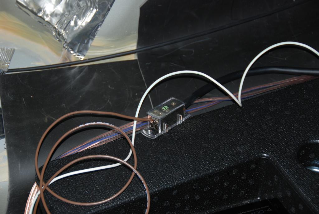

Power Blocks installed.
Positive block straight to battery. 4 gauge cable was fished through the rubber boot located on the engine firewall slightly below the brake reservoir.
Negative block connected to rear seat bolt

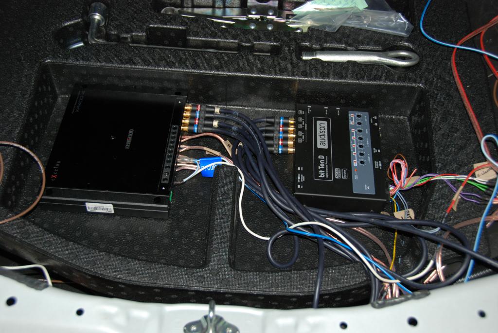

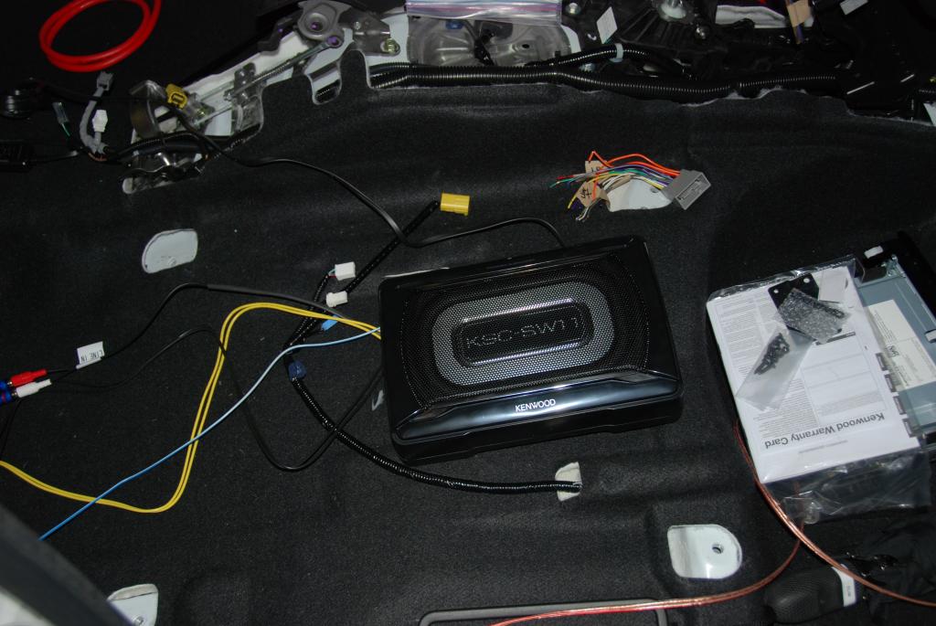

Kenwood Amp and Sound processor wired
Kenwood powered sub wired

UPDATE 10/23: Clean-up of wires started today. Will make things permanent once the testing and calibration are done.
UPDATE 10/25: Sound test done today with temporary power wires in place.

Just installed a bit ten this weekend and got to tweak it last night on the laptop. It's a really cool piece of hardware and definitely allows you to fine tune in a way you couldn't do otherwise. I can definitely notice a difference already and I'm not finished tweaking. I've got plenty of equalizing to do on that 31 band eq.
XM radio hooked
Before and in between today's football games, found to time to temporarily power-up the sat radio. Pre-fed the line the day before.
Except for a faulty audio cable
(had to take apart the center console again
- which serves me right for not testing first), it works great and sounds deadly, clear and firm. Have the sat radio's audio out (mini-jack) go into the Audison SP's Aux input thereby having its volume controlled by the Audison's DRC (Digital Remote Control). Very clean sounding indeed!!!
Haven't decided on the best placement for the XM radio. Most probably will attach it to the cubby hole in front of the dual cupholders on the center console.
The ICE installs are now complete. System sounds great but will report once the professional EQ'ing is done.
Let's see if they can get the Fit to sound better than my B&W home system.
