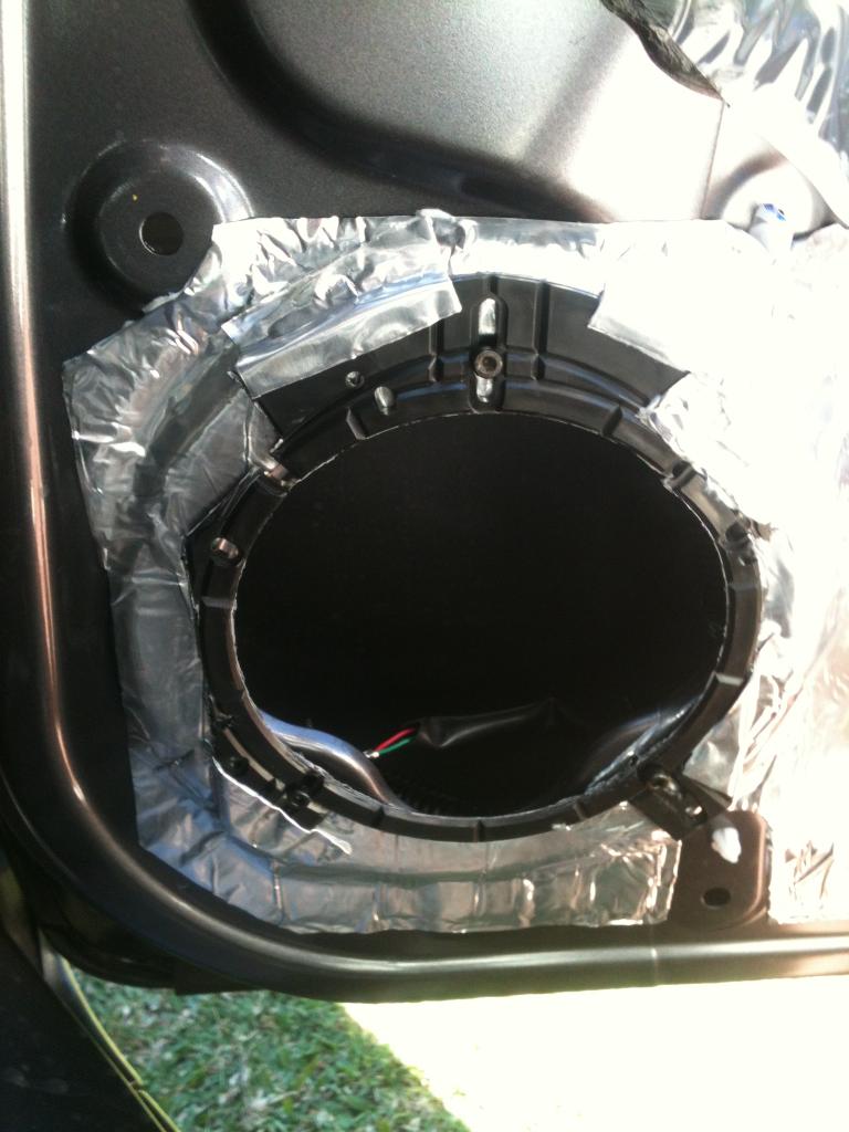

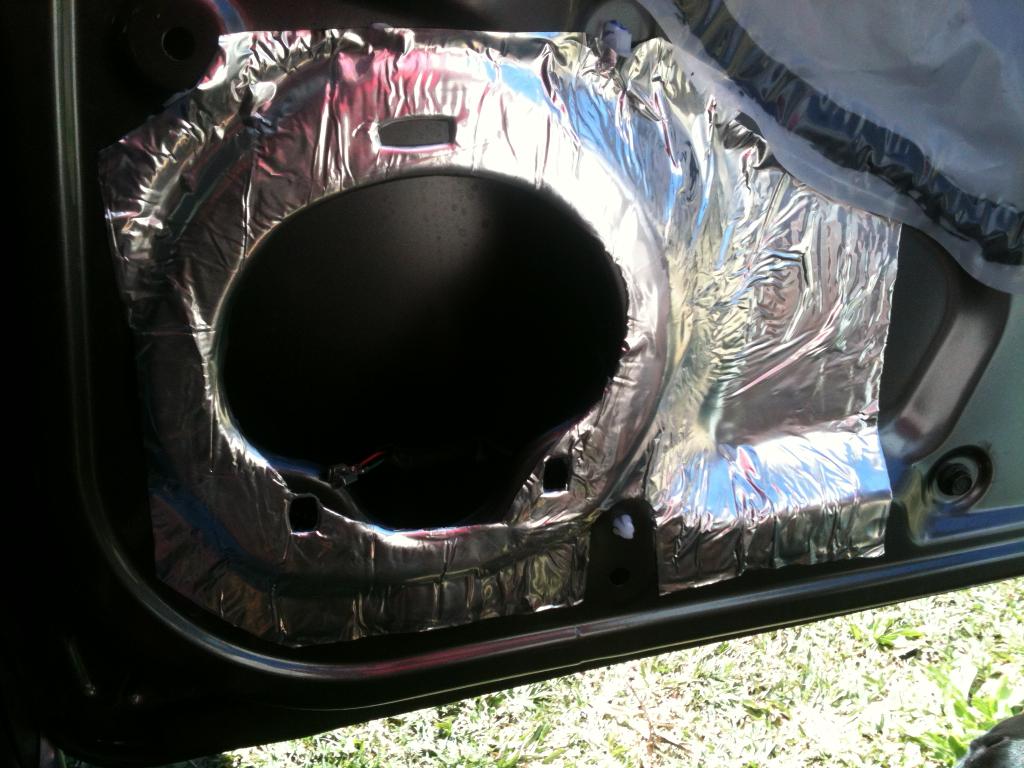

On the back doors, I was able to cover most of the inside of the skin. I have used it on the speaker mounts to both ensure a good seal and help to increase the height of the speakers even if it is only 1mm.
I have found that a few well placed bulldog clips will help hold the plastic sheet on the inside up and out of the way.
