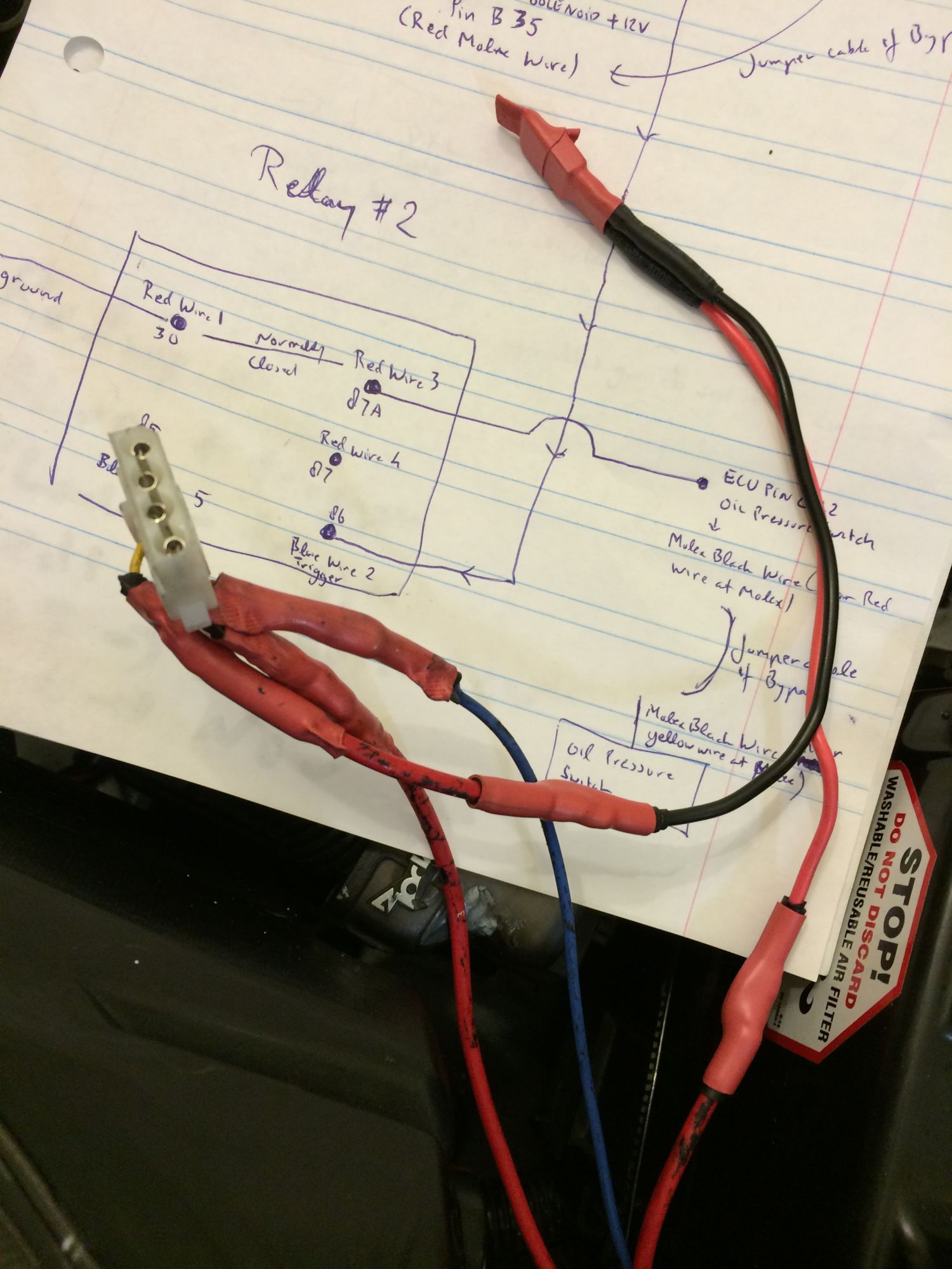

Ok,... This is what I figure will trick the ECU so I can lower the VTEC activation using AEM F/IC-6 without any check engine light...
Connect ECU VTEC Activation wire to Trigger Wire on Relay#1
Relay#1 will have power input directly from Battery 12Volts
Relay#1 Normally Open output will be connected with the VTEC Solenoid
The same output will also power the Trigger Wire on Relay#2
Relay#2 will be wired as Normally CLOSED.
Relay#2 will have it's input connected to Ground
Relay#2 Normally CLOSED output will be connected to the ECU wire that supposedly goes to the VTEC Oil Pressure Switch so basically
the ECU will never see the VTEC Oil Pressure Switch again. (unless I remove the boomslang wiring harness and connect the stock car harness directly to the ECU again.)
Please note that all this wire modification is done on the boomslang harness so no factory stock harness is cut or tap...
I will also prepare jumper switch just in case I want to by passed the relay and back to non early VTEC activation.
Here is what I predict will happened...
AEM F/IC-6 trigger early VTEC activation for example at 4,000 rpm.
ECU do not see any changes because it's output to solenoid is now isolated to relay and it's input to oil pressure switch is still grounded by the normally closed relay#2
When engine hit 5,400 rpm, the ECU now will try to activate the solenoid by energizing the trigger on relay#1 which will "click" simulating a VTEC solenoid taking current and also activating relay#2 to OPEN the ground so the ECU now "see" that the oil pressure switch just goes to open position...
I am still assembling all the parts and hopefully I am done tomorrow so I can test this relay circuit... if it's work then I can move to the next step which is.... INSTALLING MY SPRINTES

Here are the relays with Ground Distribution Block wiring connected:
Time to cut the boomslang wiring harness to intercept:
Here are the wires that (I cut) connect the ECU to the Oil Pressure Switch,
it is on Connector C Pin 22 (C22):
Now, I am cutting wire at Connector B pin 35 (B35) that connect the ECU to the VTEC solenoid:
I use MOLEX connector so I can quickly take the boomslang harness out and get back to stock, or just in case, I don't want to use the relay anymore, I can just plug in a MOLEX plu that act as a jumper:
Now, it's time to connect the relay Common terminal (Input) with the 12Volts source from the EFX Fuse Distribution Block:
Here is the Molex female and male connector connected:
Here is the boomslang wiring harness safely secure and tuck tight between the ECU:
I start the car, and NO Error code despite the ECU do not connect directly to VTEC solenoid...
so the internal resistance in the relay actually trick the ECU into thinking it is connected to the VTEC solenoid but in fact it is connected to the relay trigger.
First phase pass...
Second Phase will be driving the car on the road and see if the VTEC activate ok with no error at 5,400 rpm (stock activation point).
After that (if I pass),
then I go to Third Phase which is using AEM to lower VTEC activation point to around 5,000 rpm. if it work then I don't have to buy K-Tuner to lower my VTEC activation point
Ok, about to test drive the car now (Second Phase)...

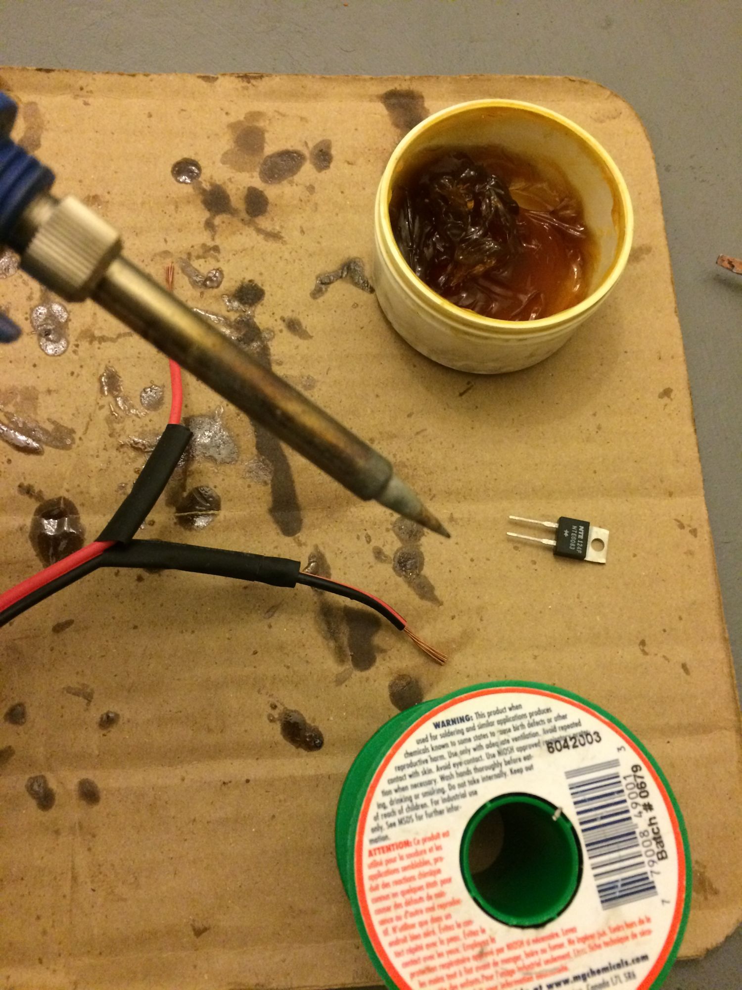

Do a test run, it run well, no error code when the rev are climbing fast past the VTEC activation point, but when I stay around the rpm where VTEC activated, I got into limp mode again...
so I literally goes back to the drawing board and drawing on piece of paper how my Relay Circuit look like...
Suddenly I realized, I need a diode to BLOCK the AEM F/IC-6 VTEC signal from going to Relay#2 and trigger the oil pressure switch open signal to ECU...
no wonder I got OBD 2627...
so tomorrow I am going to install the diode...
I should have draw my circuit properly so I can see the problem right away...
my initial sketch drawing was done in a hurry and with my head dizzy from the fume of the paint (painting Sprintex)... oh well...

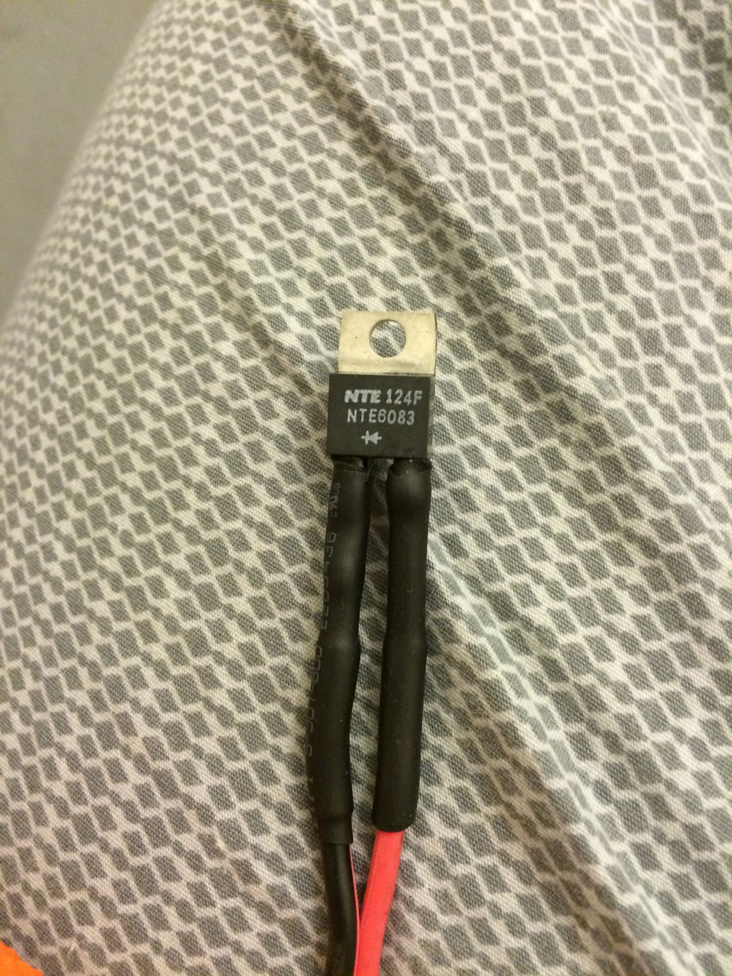

I add the Diode to the Relay Circuit this morning:
Tuck the Diode wiring behind the ECU cover with Rubber Large Heat Shrink to protect it from vibration and environment:

Test Drive the car again, set the AEM F/IC-6 to activate the VTEC Solenoid at 5,000 rpm for now,
and... SUCCESS !!!
No more OBD error code, the ECU never knew that the VTEC had been
activated lower than 5,400 rpm !!!
So for anyone interested in doing this modification,
here are the diagram:
