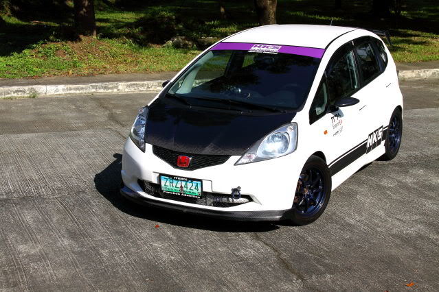

Sharing my build to Fit Freak...
HKS FIT GE-6
Type: 09 Honda Fit GE6 M/T
Color: Tafetta White
Purpose: Daily Drive, Time Attack, Autocross Track Tester
SPEC SHEET:
Propulsion and Engine Bay: L13 Engine, HKS R Suction Intake, HKS Turbo Kit, HKS SQV Blow Off Valve, HKS Intercooler, HKS Universal Oil Cooler, HKS Cat Delete Down Pipe, HKS Midpipe, HKS Hi Power Exhaust, HKS Super NA Racing Oil, HKS Rad Cap, HKS Oil Cap, Skunk2 Reservoir Hats, Megaraizin Grounding Kit, Skunk2 Battery Tie Down
Stance: Dynamics Coil Overs, Cusco 2pt. Upper Strut Bar, Cusco Rear 2pt. Anti Roll Bar, Cusco 4pt. Front Lower Brace, Cusco 2pt. Lower Strut Bar
Resistance: J's Racing Slotted Rotors, Stock Calipers, Endless Ceramic Brake Pads
Rims and Rubber: 16x7 +42 CE28 Magnesium Blue/ Bridgestone Potenza Adrenalin RE 001 205/50 R16
Exterior Upgrades: Carbon Fibre Hood by Stage 21, Carbon Fibre Chin, Spoon CF Wing, Spoon CF Rear Diffuser, Spoon Side Mirrors, GE8 Rear Bumper and Side Skirts, Front and Rear Type R Red H badges, Honda Access Red 6 LED 3rd Brake Light, Polarg Headlight Bulbs (All Weather), Raybrig Park Lights (Pure Amber), ITR DC2 Amber Fender Cheek Lights, Cusco Customized Towhook, Honda Access OEM Window Visors
Interior Upgrades: FD2 Steering Wheel, Type R Red H Badge on Steering Wheel, ARC Titanium Shift Knob, Honda Access Pedals, Recaro SR3s Seats, Bride Seat Rails, J's Racing C-Pillar Bar, J's Racing Rear Upper Strut Bar, J's Racing Rear Cross Bars, Spoon Sports Rear View Mirror, Solargard Clear Tint
Electronics: HKS Turbo Timer, HKS EVC S Boost Controller, HKS F Con iS, Pivot Engine Push Start, Pivot Shift Indicator, Garmin GPS System, DEFI BF Guages (Water Temp, Oil Temp, Oil Pres, Fuel Pres) and DEFI Link Display
Tuned By: DTM Motorsport Real World Tuning
Audio/Video: Stock/ I Pod
Props to: GARAHE R.L. Cruz Motorworks, Emperor Motorsports, HKS Super Oil, DZ Racing, Autoplus, Pitworx Hongly, Eurodecals, Benj Magtoto III, Dolf Santiago, Tommy Teng, Jonas Salonga, Carlo Lee, Edward Dela Rosa, Rex Tan, Marion Martinez,Jay Jay Pompa, Stage 21, Bridgestone, K92 Auto Refinish, Waxdaddy, BRE Blanco Race Engineering, Auto Kozmetix, Andeng’s Carwash
Mad Skills By: Edward Dela Rosa, Jay Castellano, Don Pastor, Team Flat Out
Websites: Function Addiction, GE GaragE, JDMUnderground.ph, NWP4LIFE.com

Very nice! I like what you did to your Fit, especially the HKS kit
How is the fitment of the turbo kit? Is there enough room where the turbo and manifold is located? I'm planning on getting this kit sometime in the future.
Old Jan 1, 2012 | 07:45 PM
Garahe's Avatar
Posts: 18
From: Philippines
Thanks!
The HKS Turbo Kit fits like a glove. Did not encounter any issues with the install.
