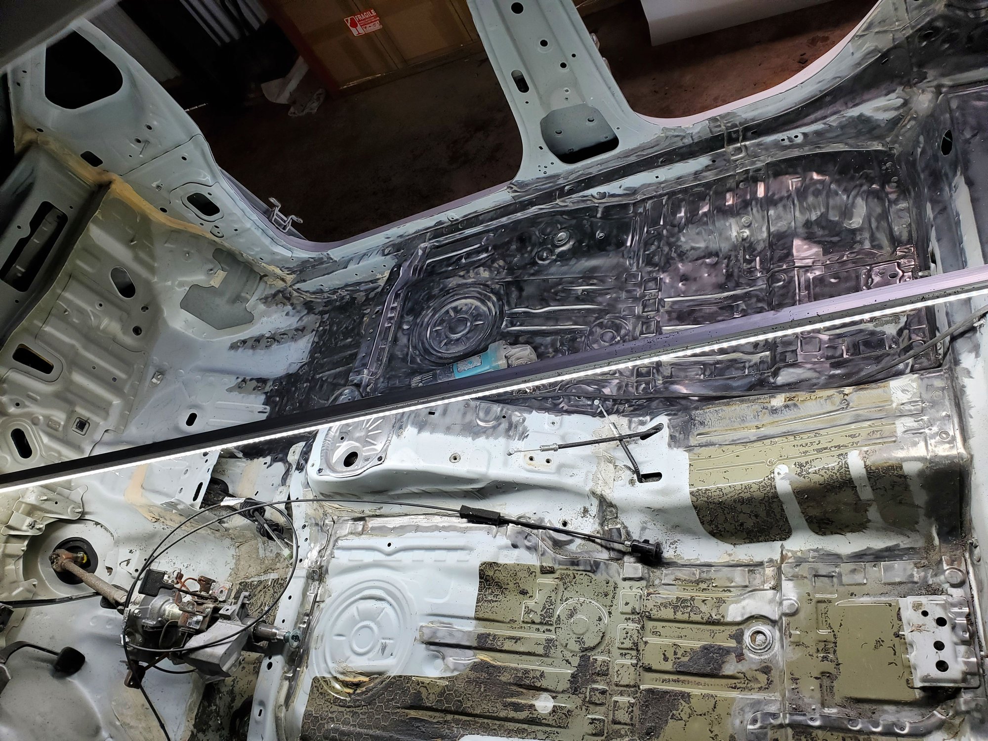

OK, here we go. I have dropped the Fit off with a builder to strip my interior and do my roll cage. Basically we're going to prep the car for COTA Super Lap Battle in February. That is less than 5 months away. The car is going to be transformed, as if it wasn't already... Car is going to get race seats, likely a race dash, full roll cage, fire suppression system, cool suit, lexan windows everywhere except the winshield, maybe a fuel cell, if not a wild diffuser. Roll cage will be built to connect to aero in the rear, NASCAR style door bars. Might be a few more surprises. Standby to standby. I will add pictures as they come up. @CarbonTek @evilchargerfan @elkaku @Myxalplyx @Revhappymatt @KTuner @Elpapas @Azuki

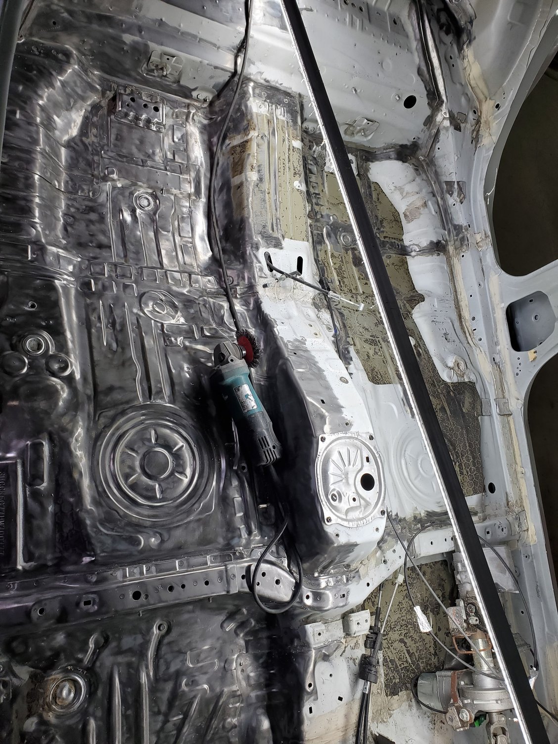

we left the dash in for now. I'm having all the panels stitch welded which means removing all the seam sealer. I think he's going to weigh it before the roll cage. I'm hoping for 2200lbs... roll cage could be up to 400 lbs... time will tell

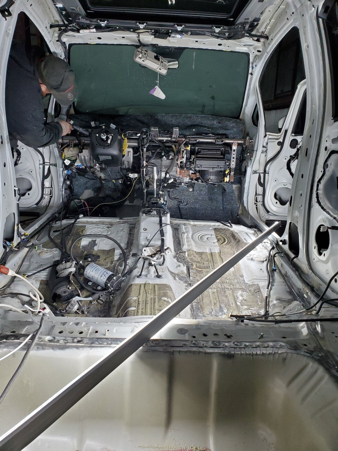

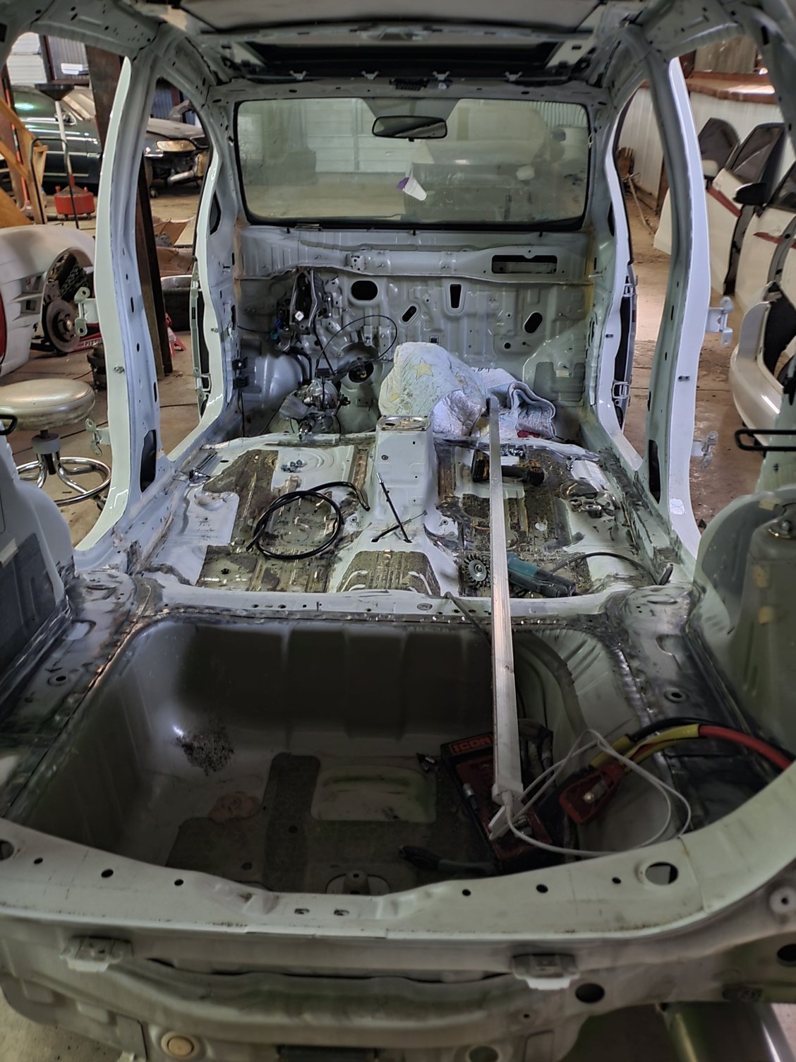

Finished gutting
probably dropped another 100lbs with wires, noise reducing material, and other parts. I'd love to get to 2000 lbs!

more progress. It's gotta be under 2000 now, right?
