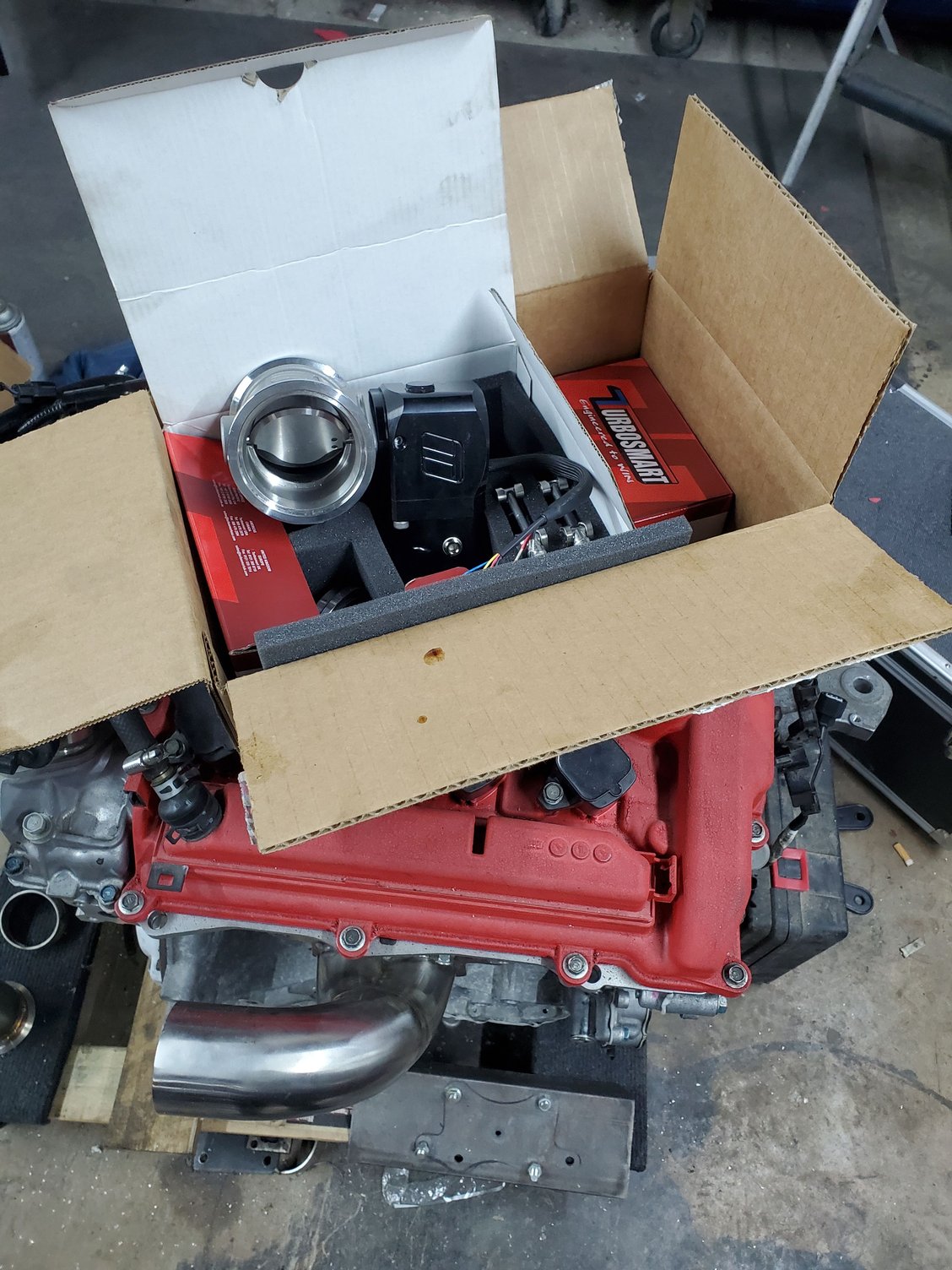

What's up y'all? Long time no updates... It took about a year to do all the seam sealer removal and getting the car down to bare bones, working on nights and weekends in the shop. Anyways, we have the main hoop tig welded, and are working down bars right now. Cage should be complete soon. We are using a product called Steel-It to protect the metal. Whole underside and interior will be painted in a two-part epoxy coating that can be welded through since it has 304 stainless in the paint (for future repairs etc). We have started building the turbo piping but we are waiting for the transmission to come back from Team RIP Engineering in Kalamazoo Mich... They are going through the whole box and will maximize the torque handling capability of the stock trans. It still has the mFactory LSD in there. I have an electronics guy that is building a complete electrical racing harness for the engine. We are using a cannon plug in the firewall to enable us to drop the engine quickly Additionally I am offboarding some of the sensors to a Rife sensor block that will prevent unwanted vibrations from compromising the sensors. To help manage the boost, I got a Turbonetics butterfly valve waste gate that will support 50 psi very accurately. I also got their controller to manage the system. My builder designed and built a front mount intercooler that goes where the radiator used to. We are mounting the radiator just in front of the fuel cell. Fuel cell will sit in the forward most portion of what used to be the spare tire well. Radiator will receive air through rear door ducting that we still have to make. I have an electric water pump for the rear that flows plenty. To convert from the NA build, I went with the Brian Crower rods for the L15B1 from the Civic. They were supposed to be the same just shorter (to get to 10.4:1 static compression ratio). Turns out the fit has a smaller wrist pin (go figure) so I had to have them machined to work. I have them back and the engine is going back together as we speak. My thrust bearings showed significant wear after only 100 break in miles, and I heard that is due to the Clutchmasters Stage 4 clutch I have on there We're going to put a pressure relief valve in there or use the computer so it won't start with the clutch in... Still a lot of work to do. Hoping to have her running by 1 June, we'll see...

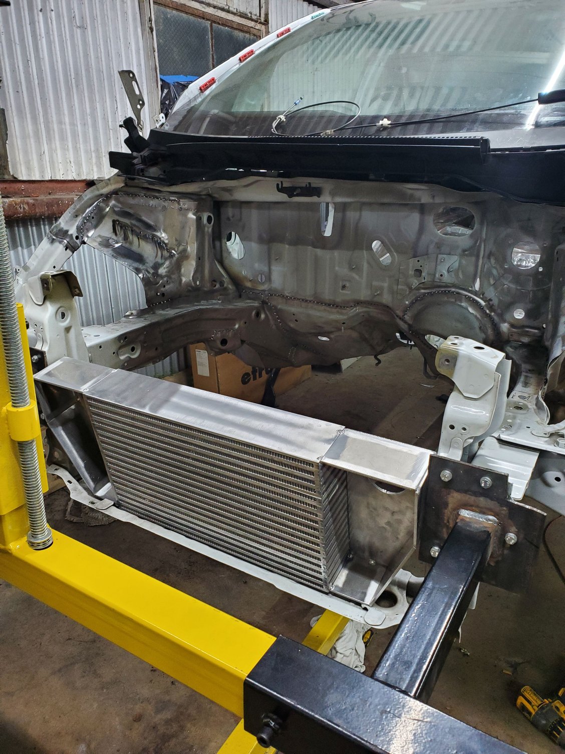

Intercooler will sit here and entry and exit on reverse side...
Turbnetics wastegate and start of hot side turbo pipe.

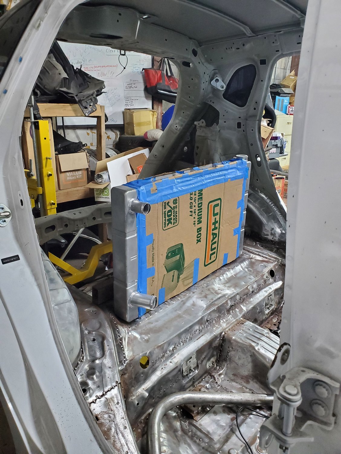

Radiator will go here! Not this radiator but...

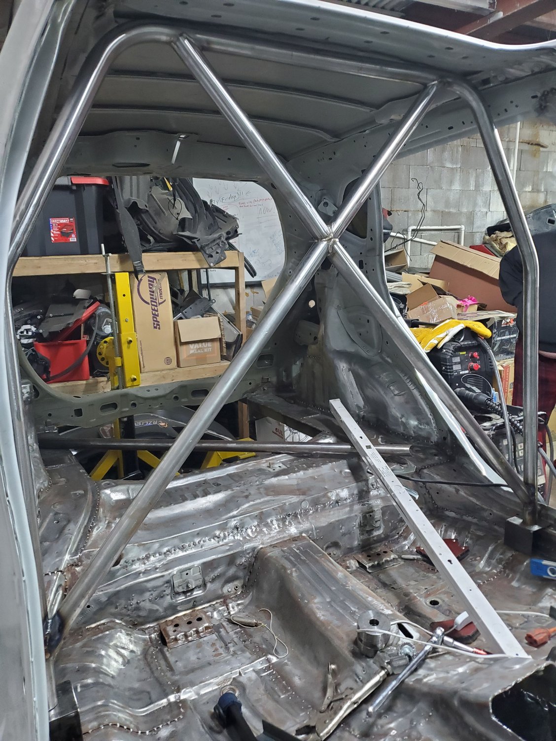

Getting there. This main hoop is all tig welded now.

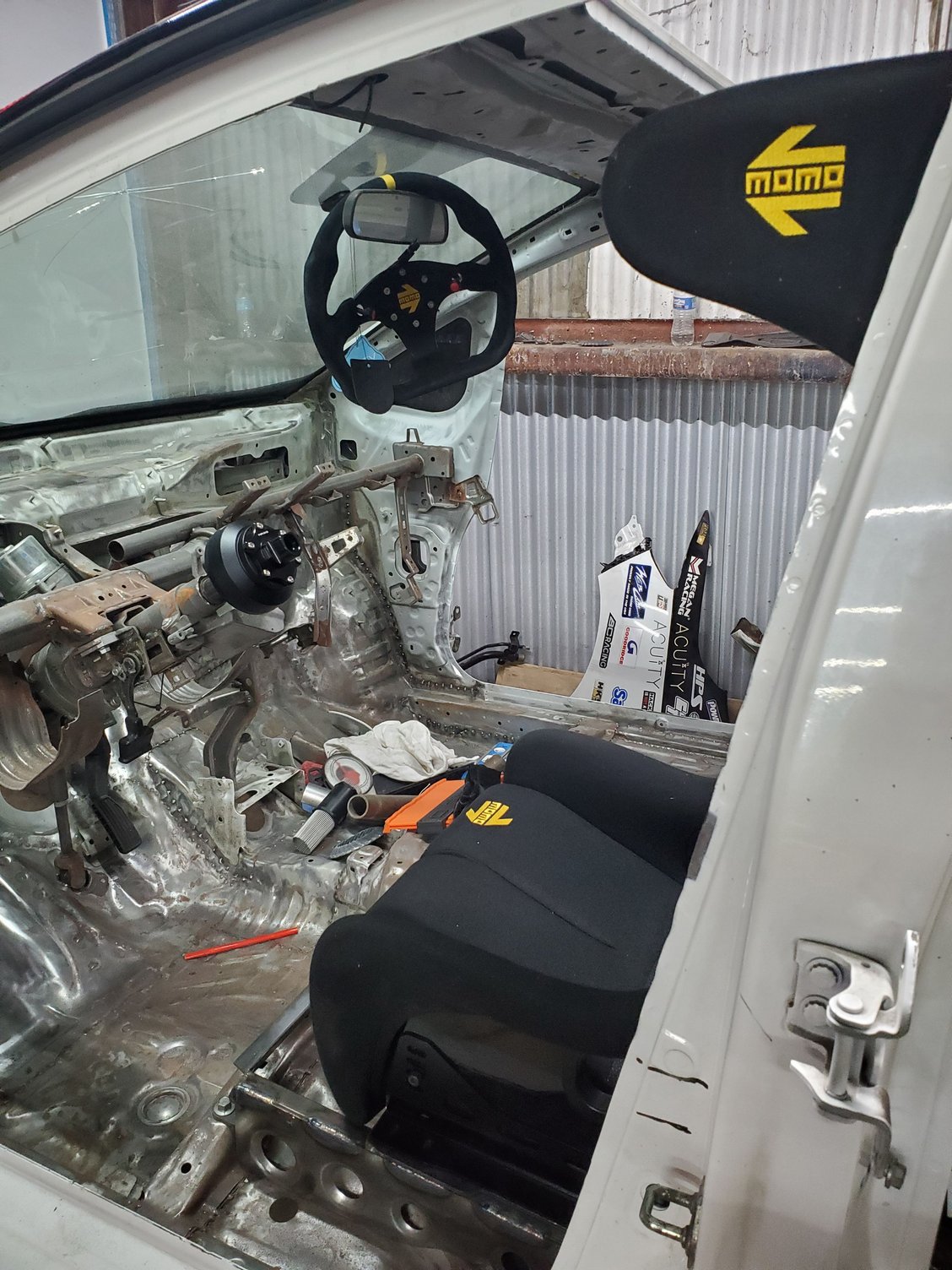

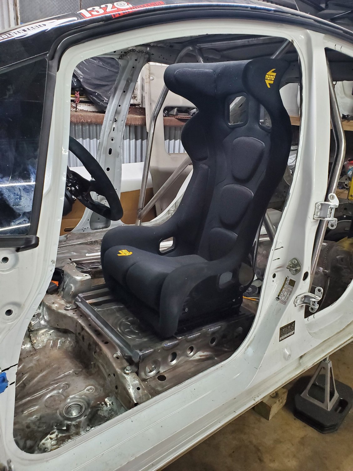

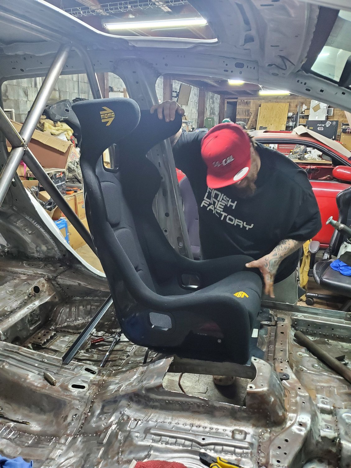

Fitment testing the new momo. We got a Sparco seat bracket off scratch and dent sale for $15

Building out the landing spots for the cage.

Main hoop from the windshield view

Interior updates
Couple more goodies coming in finally...

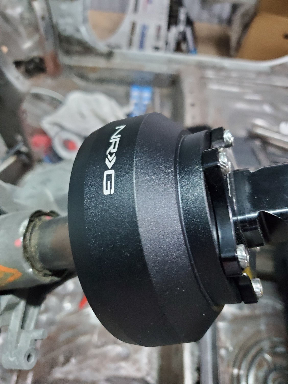

NRG hub and steering quick disconnect.
Momo D ring steering wheel with suede and two buttons.
Basically where I'll sit.
#racecar
