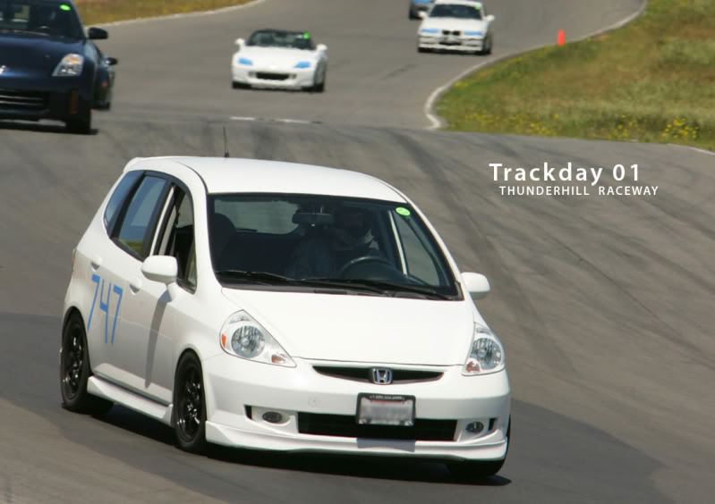

Happy to have the Fit as a track car, and Thunderhill is a fantastic track.
NCRC racing is a great way to get into this.
