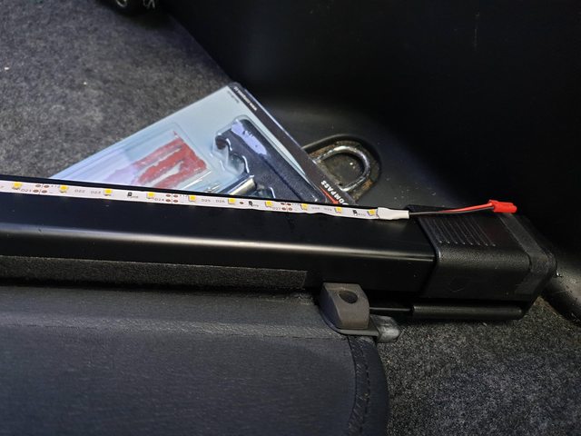

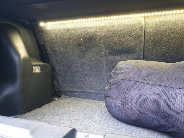

Which gen Fit do you have? I just installed a LED strip into my GD. I stuck the wires through the driver side seatbelt hole, fished it out at the strut mount hatch, and finally pushed it to the stock lamp housing. The strip is glued to the cargo cover and can be disconnected if I need to remove it.
