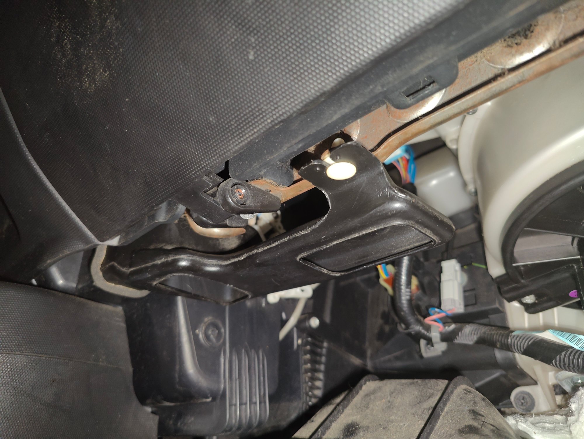

Found it
After having the same issue and spending a while digging and finding nothing helpful. I got someone I knew to look at their put together fit and we found it.
Passenger side air duct location
To get it lined up look to the far right side very near to the bottom panel of the center. There is a rectangular gap that the foam side fits on. The plastic snap will then line up with a hole in the metal frame.
Hope this helps anyone in the future.

Thank you!
That worked @BarretJB !!!
Thanks for your helping picture and message!
