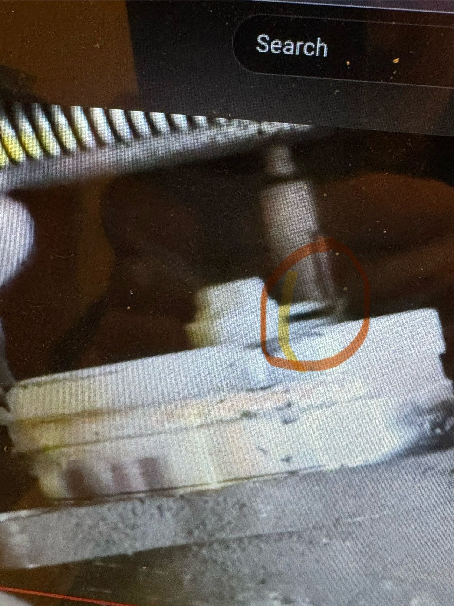

So I replaced my rear wheel hub assembly on my 2015 Fit EX today, but when I went to replace what I assume is the ABS sensor that attaches to the hub via a screw, the plastic piece broke. So now the ABS light is one, tire sensor light is on. I can’t seem to find the right part to fix this, can anyone help?

It seems to be a very common problem. If you are able to remove all the pieces of the old sensor you should be able to replace it with a new one. If part of the sensor broke off in the hub you may have to drill it out.

Thank you for this. All the pieces are there, cause i screwed it into the hub, and then the plastic broke. I've seen the problems where people are having to drill out where the sensor comes into the knuckle, but this is a totally different set up, the wires come straight through and attached to the hub. I can't find anything about it anywhere

Where the circle is is what broke today
