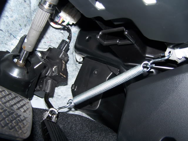

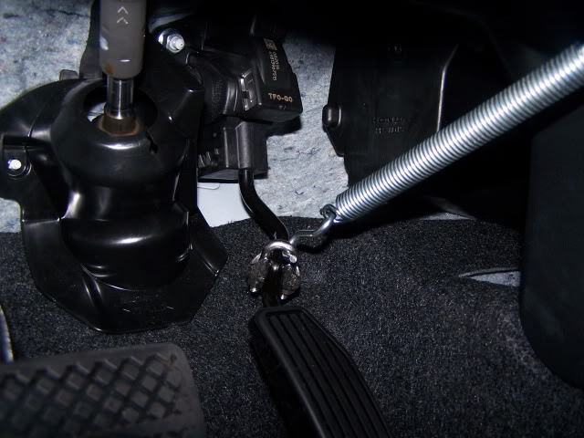

Here are my pics from Page 2 almost two years ago. I forget I have done it most times.
