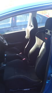

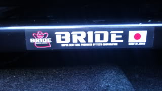

Finally got mine done:
Recaro finally in (on Bride rails) 8)

Just took a few pics on my phone so will get better ones when i get a chance but i LOVE them!!
EDIT- this is for a GE6

Congratulations man. Those SR5s are sweet! I see they have a different material on the shoulder area too.
Did you run into any problems with the passenger-side sensor plug?

With the Bride rails, they include a bolt where you mount the OEM seat belt bracket onto the rail so I literally pulled the wiring from the OEM buckle and mounted this onto the Bride ones with this Bride bolt (sorry if its confusing)
