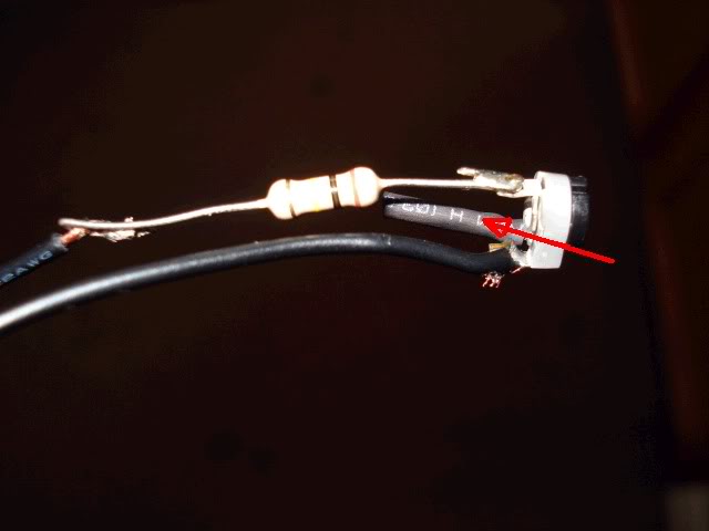

Did you just put shrink wrap around the third prong, and there is nothing soldered to it? (highlighted red)

yep shrink rap it the third leg

Yup, but if the others are wrapped and you put real big shrink wrap around the whole dingus you don't really have to. If you connected the bottom wire to that other prong the knob would adjust backwards but would still work the same way.
