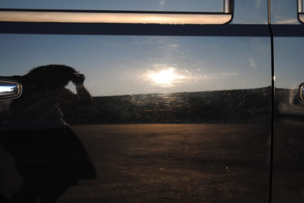

Here are some Before Sun shots

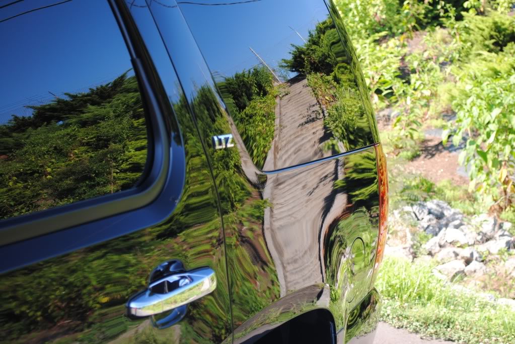

Here are some Final Sun Shots. 97% correction was done, this paint was very hard and needed the big guns brought out to level out the paint correctly.
