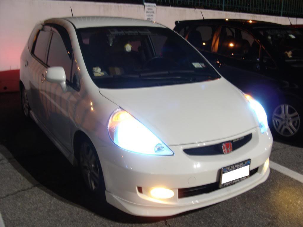

The arms were swapped but the wipers are in the right spot. See the following picture that I stole from another thread
Once you swap the arms back you shouldn't have any problem. Good Luck!

it looks like your wiper arms are on the wrong side, and your wiper blades are also on the wrong wiper arms.
longer wiper arm goes on passenger side, longer wiper blade goes on driver side.
how'd you do that haha
