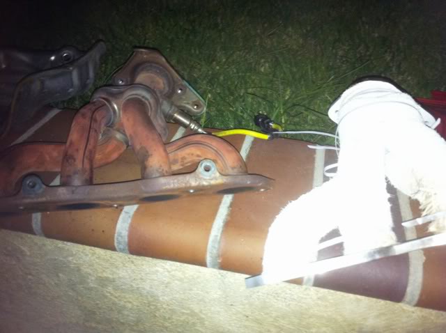

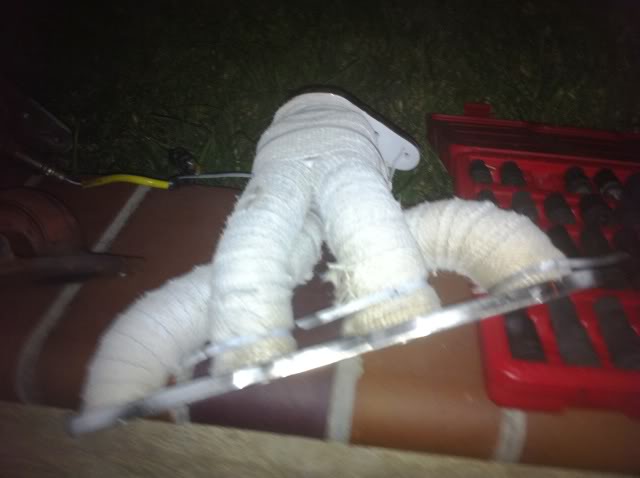

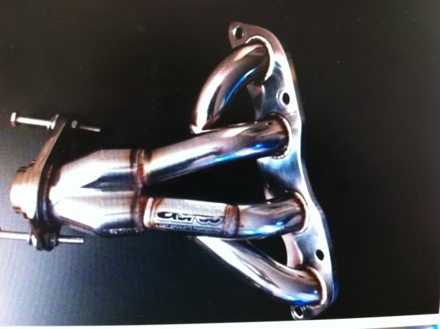

bought this off another member for $200. Installation was fairly easy although it did take me 2 days (at night) to do it with a friend of mine. Getting the bolts off was the hardest part of this installation, especially with so little room to work at. in a perfect world, the header would fit on perfectly, and surprisingly it did. The Fit was perfect and bolting it back on was a breeze.
Now owning it for almost 2 months, the header does make a difference when driving 60mph+, and does feel stronger mid range. But I also noticed a big drop on MPG. I was not happy with that at all, so i was gonna get a tune after finishing my intake setup. It was not until last week, when I got my oil changed with synthetic oil, and that was the key (i did my header install during my first cycle from regular oil to synthetic). I noticed that my exhaust was louder and responsive again. MPG's right back where they are supposed to be, so overall very happy with this purchase.
