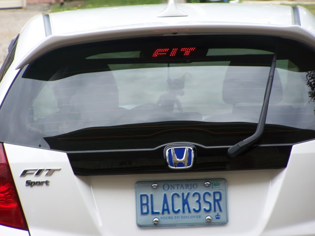

You could try using a screw extractor. Basically drill a hole in center of the screw and insert the extractor which has reverse threads. Then replace with a Shark Fin antenna.
