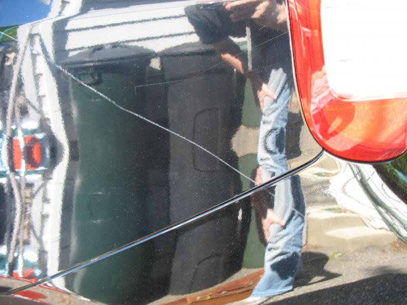

I have this long mark on my rear driver side panel. It was windy one day, and an old ironing board (with no cover) sitting out for garbage, fell and left this long paint mark. It didn't cut through the paint, just marred it. Any ideas of what would work best to remove it?

That looks like a surface mark. If so, that should come right out. I've always had good results using wax and a little elbow grease.

I just quick waxed the car the other day but that didn't do anything.
I was able to rub off a small portion that wasn't so stuck on there with my hands when it first happened but this portion left is tough.
I don't want to start scraping either for fear of scratching the paint.

My neighor had something similar on his car and I was able to get it out using this polish by hand:
Something on the surface like that is an easy fix

I actually have a Turtle Wax polishing compound that I haven't tried on it yet. For more cutting action, it says to use a soft cotton towel and for less action, a sponge. What kind of towel is okay to apply, a microfiber or should it be terry cloth?

I would use a microfiber towel or applicator pad and follow it up with a little wax or sealant

Don't mean to be captain obvious but have you tried claybar? Often times I find marks, streaks and little black dots that I think are stone chips and I give it a shot of claybar+lube and it takes the stuff right off!

I strongly advise against using turtle wax compounds, I've red too many angry posts on forums of people getting very bad results.
I might give Meguiar's Ultimate compound a try first. You can use a terry cloth to get it to cut more. You might finish afterwards with a polishing compound. People swear by M205 by meguiars from the pro line.
I question whether a polishing compound has the cutting ability to get rid of the paint park which is why I recommend a more aggressive compound. I've used ultimate compound and it finishes pretty well with not much marring. I still finish up with M205 and it finishes to a high gloss.
You might try a polish with a MF cloth or a foam applicator and if that doesn't work, move to a terry cloth with a more aggressive compound and then come back to the MF + polish. Remember that you need to put some elbow grease if you are gonna remove defects and then rub more lightly for the post compounding polishing step. Don't forget to use a sealant afterwards since you will effectively strip any wax or protection you had on there.

I've used the Turtle Wax polishing compound on the roof and hood when I first bought it and it seemed to work very well. Gave the paint a deeper more wet look while getting rid of light oxidation.
I do have a claybar as well, just haven't gotten around to trying either method yet. Thanks for the advice.

I had a similar scratch on the fender of my 350z and got it out on Saturday using my machine, I think you should be ok using it by hand as long as you use some type of compound (if the claybar doesn't work)
