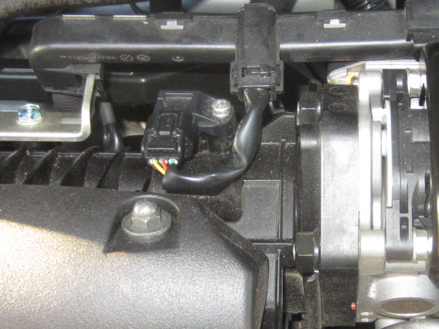

How do you remove the MAP sensor?
The screw holding it is a Phillips and is VERY tight, don't want to strip the head.
It's in a tight space, not much overhead room.

the sensor
hmm....not sure if its called the MAF or MAP sensor but it should be on the top of the filter housing.....so there should be overhead room.
On my 2009, it is located just after the filter housing cover, connected by 2 phillip screws diagonally apart from each other. I if you purchased that sensor cleaner spray some on the screws to loosen things up without any errant drip-downs from compromising the sensor (no wd40)
try to get a different set of phillps, they can strip if the head you are using doesnt match up 100%.
Good luck.

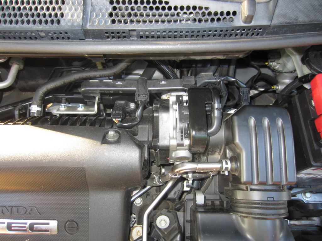

Update:
Sprayed the MAP cleaner on screw only and waiting a while.
It is a MAP, I have the Honda 07/08 Service Manual, it shows it and locates it.
See the BAD screw.
