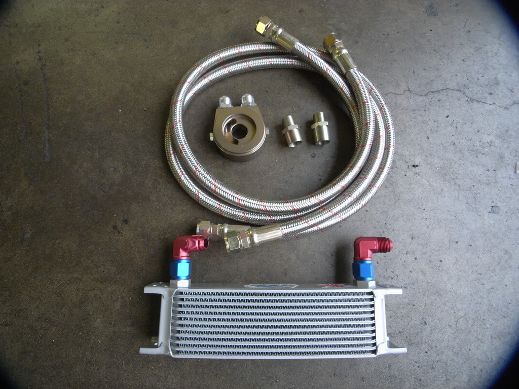

Old Sep 27, 2008 | 07:44 AM
FELIXY69's Avatar
Posts: 2,790
From: RICHMOND BC CANADA
Old Sep 27, 2008 | 11:02 AM
xtreme's Avatar
Posts: 369
From: Thailand
I have never been able to figure out in my head where it connects too.. Thats the only reason i never got 1
can some one show me where the oil comes from and goes 2 please? will help me alot befor i go ahead and get 1.
Thanks
