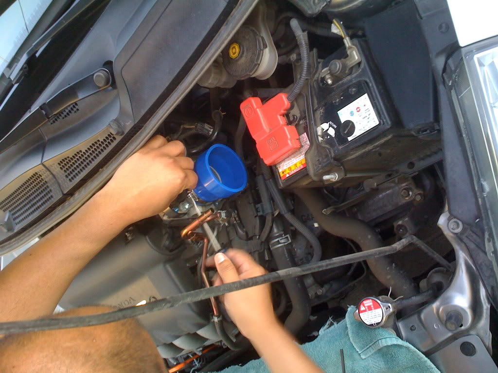

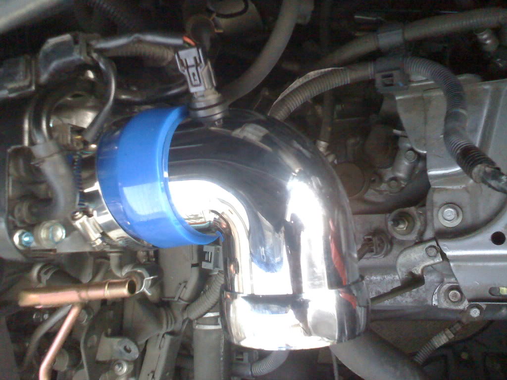

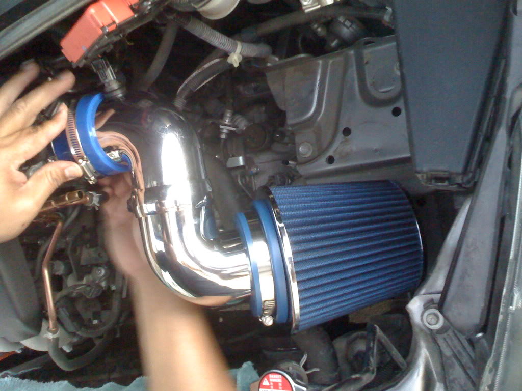

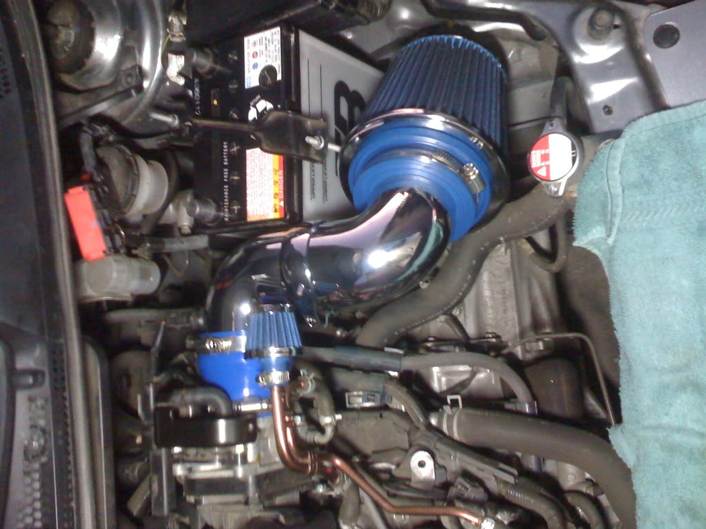

Alright, so I couldn't decide on a good intake, so after reading about the homemade intake and all the positives on it, I decided to build one for my fit. Once again, with the help of my big bro, all of this was accomplished.

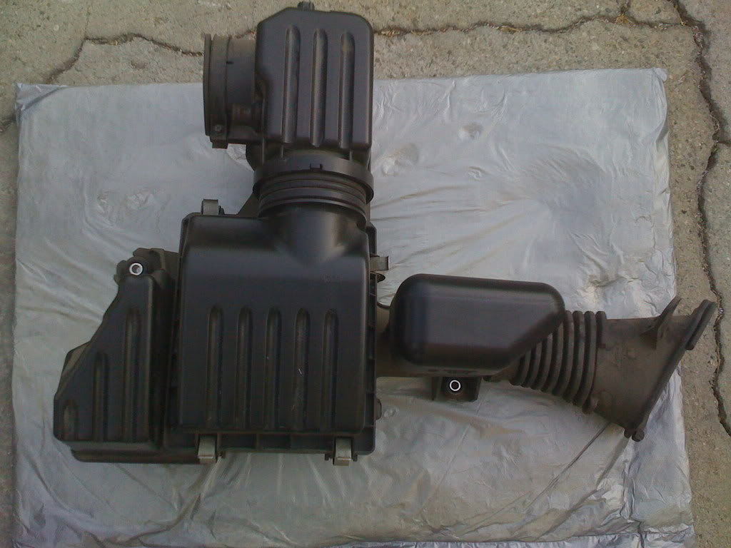

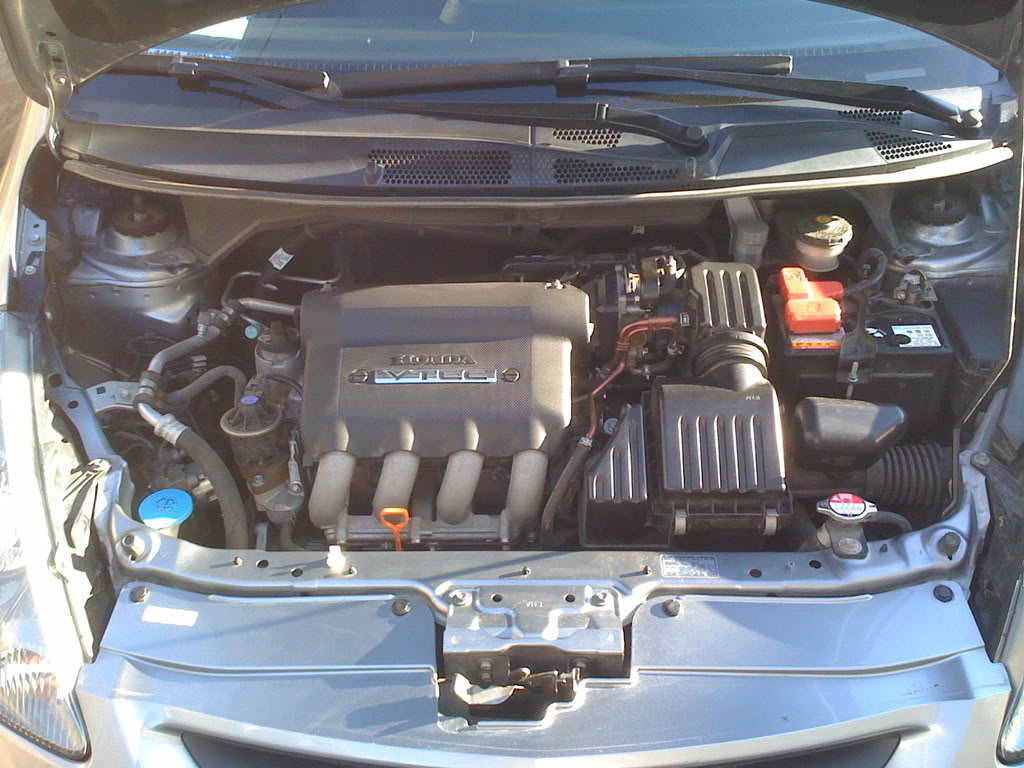

stock

two bright holes are the screws you need to take off.

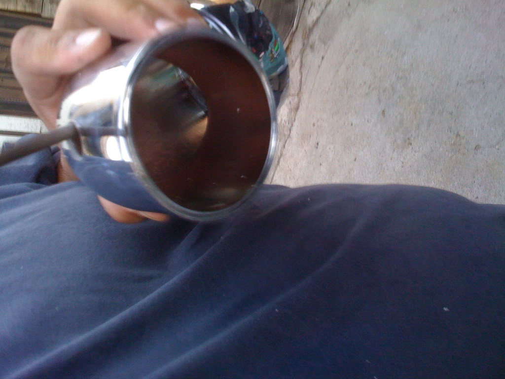

debur, always a must!

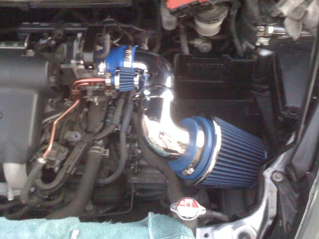

If done correctly, you should not have any CEL

looks great. i didnt think about taking the battery out.... DOH. any who. its worth the extra 8 bucks to get the silicon coupler instead of the one that came with it. looks better and i think it holds better. and plus you dont gotta fool woth them darn O rings. but none the lees GOOD JOB. can you tell the difference. and dosnt it sound awesome?

big difference coming up the hills in the canyons. Car drove beautiful, gas spendage, extremely good. well worth the money.
