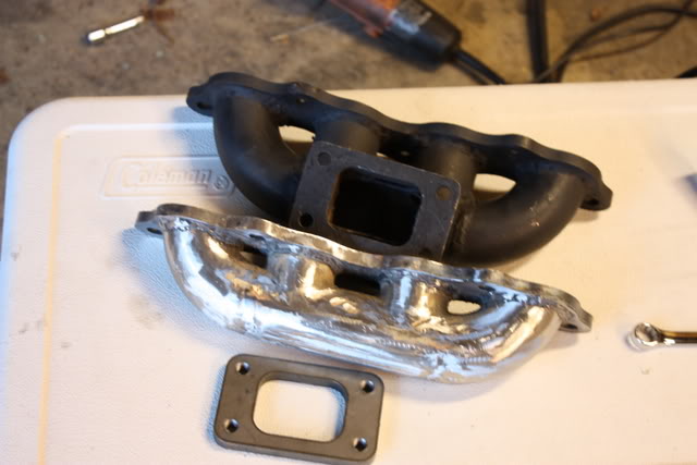

Old Feb 17, 2009 | 12:20 AM
  #39
quangalang's Avatar
Joined: Jul 2006
Posts: 667
From: california
just posting a pic of what i have gotten done up till doday. school has been pretty hectic, with work and other things i have to take care of, it's hard to find time to work on the project. hmmm i really dont know if i should do a topmount turbo or bottom mount...
with a topmount it's easier to route the dp and charge pipe, but i dont want to run into heat issues with the coil packs and the lines by the firewall.
do you guys think a nice heat shield will solve heat issues?

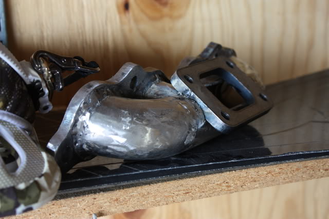

Old Feb 21, 2009 | 01:10 AM
  #40
quangalang's Avatar
Joined: Jul 2006
Posts: 667
From: california
Top mount it is then! Name:  IMG_5280.jpg
I have exams all next week so ill try to work on it sometime next weekend.
