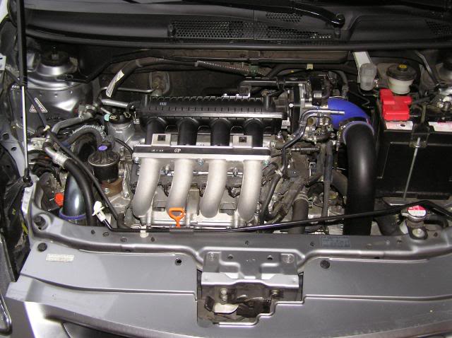

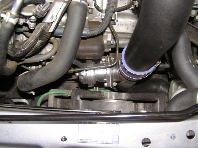

Alright little ladies and little girls, after my ghetto rigging my first setup together and having the turbo go out after the first week without even going into boost, i got lazy to finish things up right... so since i have a couple of weeks off of school now i might as well finish things up...
here are some pics of my progress:

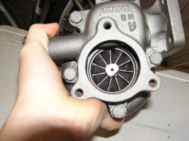

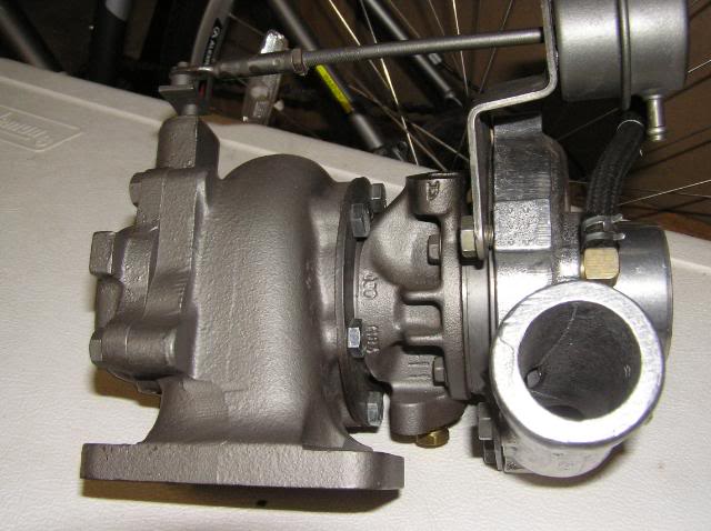

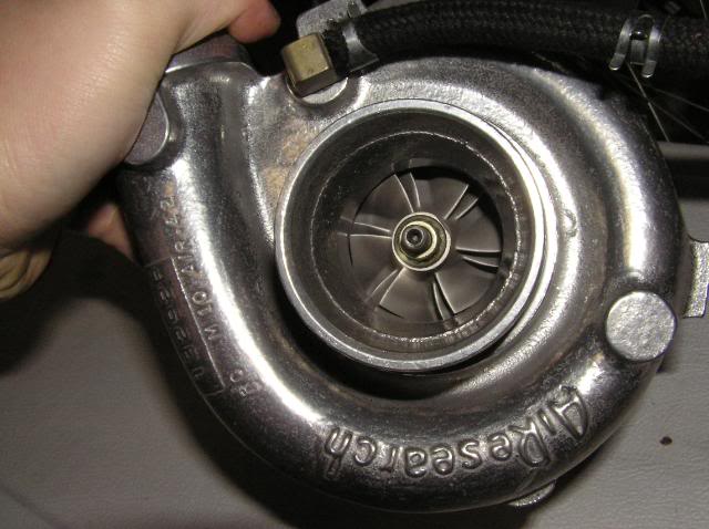

my new turbo t3 ar .48/.42
old turbo and new turbo

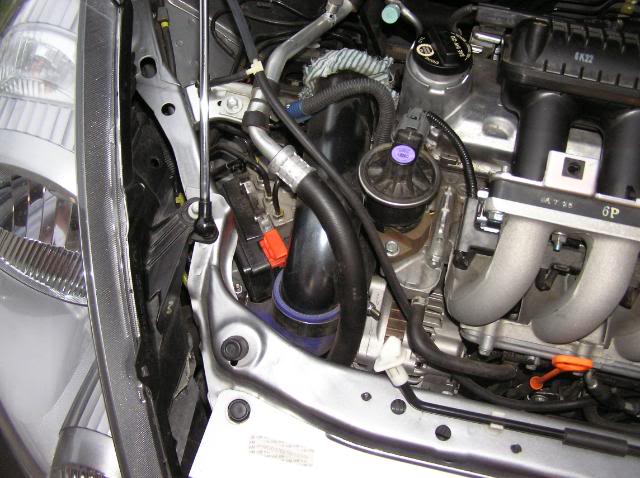

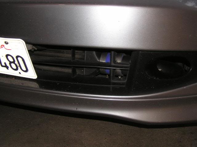

Charge piping pretty much done an intercooler is on

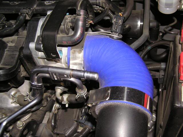

How i did the IAT sensor

BOV installed

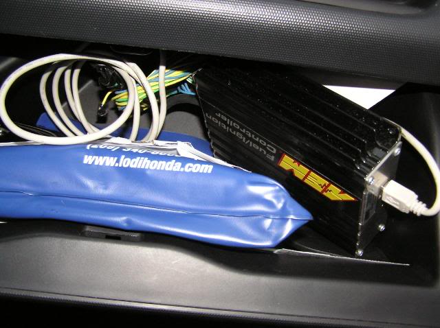

AEM F/IC installed and shoved into the glove box, i need to mount it for good though...

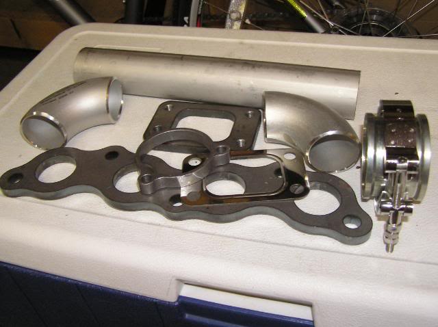

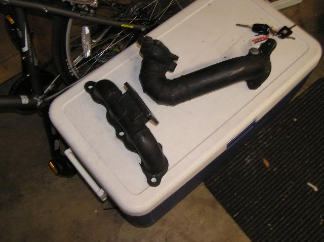

OK new materials for new manifold and downpipe

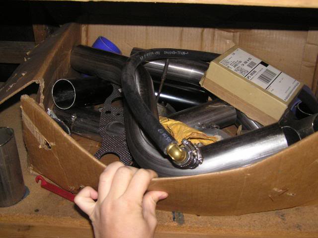

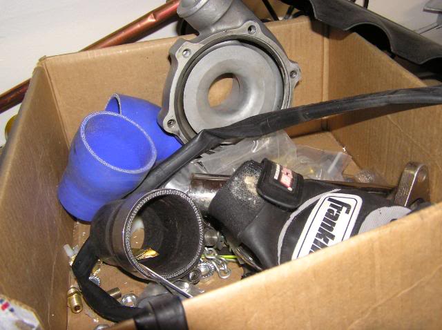

box of misc stuff #1
Box of misc. #2

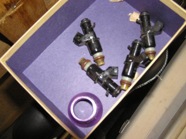

Stock injectors anyone??
Just for kicks the OLD manifold and downpipe lol Dont hate!

what happened to your first build? what did you do half assed that caused it to fail?
what hoses are you tapping into to get the vacuum source for the BOV and your boost gauge?
btw, im using a turbo thats very similar to taht and i cant get the damn exhaust side free from the center to clock it properly. ive tried wd40, pb blaster (let ti souck for about 15 hours) and a blow torch...nothing has worked.
any ideas?
the oil return fitting is about 45* away from sitting vertical and im afraid that since its gravity fed it wont drain properly like that....

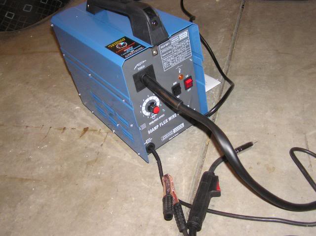

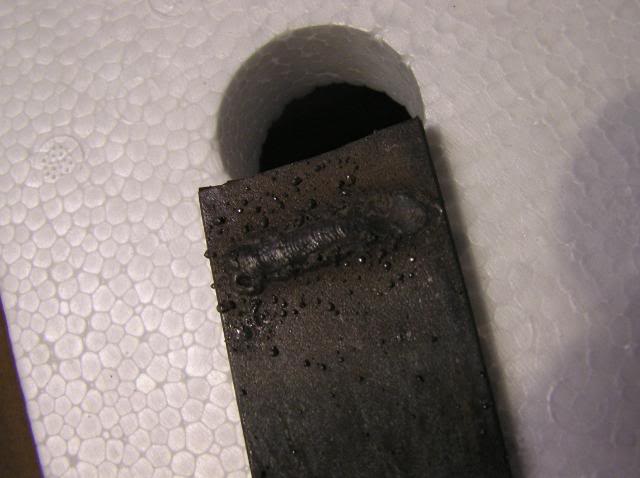

harbor freight flux core welder!! it was only like 100 bucks.
and it welds alright, i took an angle grider with a wire wheel on it and cleaned it up after i took this pic and all the slag came off and it looks just like any other clean weld. this should help with finishing up my downpipe and the rest of my charge pipes.
overall im content with it

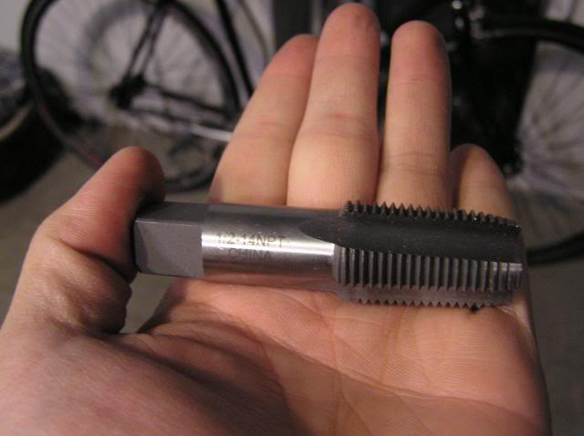

and this sucker! to tap my oil pan haha
