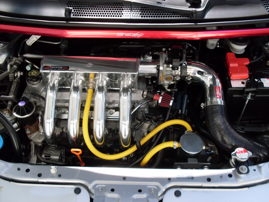

installed WR oil catch can
Old Apr 12, 2009 | 10:42 PM
im the fit's Avatar
Posts: 787
From: plantation,florida

god i want a wr intake mani n header...friggin bad lol high five on the install though

looks awesome! notice any big difference with the manifold?

Sweet setup
Wait... isn't the catch can supposed to go between the vent and air intake? You have a breather filter & the intake is capped.

my buddy gave me a weapon r catch can but i didnt use it because its no different than their water overflow tank so its sitting in my garage. i even powdercoated it but i like my arc one much better

The thing is after installing the intake manifold I replaced the tube that goes from the crank case to the mani with a clear tube, then I noticed that oil was going up the tube into the mani and theres alot of vacuum so I couldnt put a breather can because of that.Also theres was over an ounce of oil in the manifold.While I had all of that off the intake elbow had a splash of oil so I capped it and put a breather.(and I dodnt over fill my motor with oil)with the intake manifold I noticed more torque and top end and with the race headers I got really great response and acceleration and thats without any sort of piggy back, Im planning on getting an FI/C soon.
