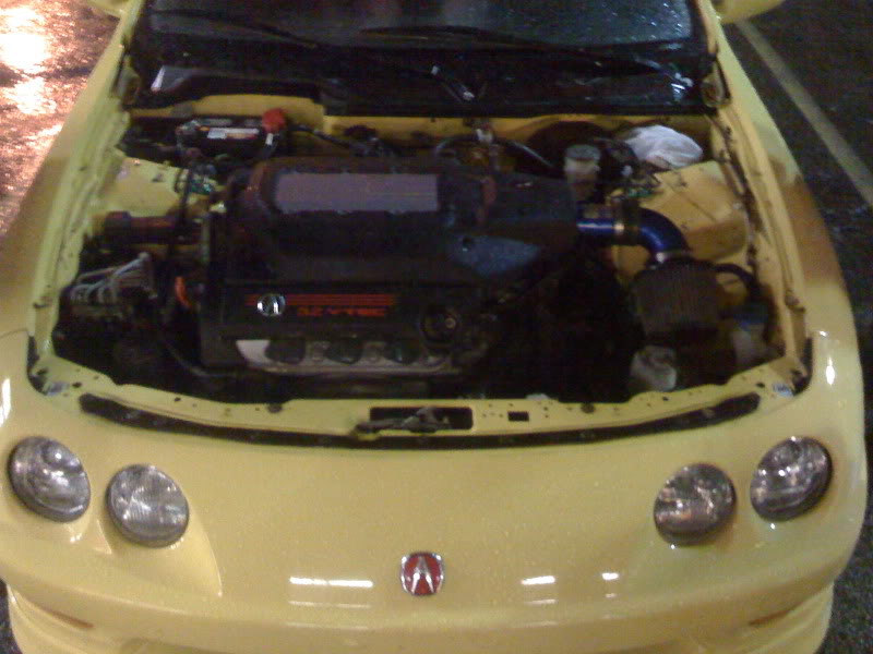

There is a local guy that has a J swapped Type-R. I think he bought the Type-R after it had been stripped, so there was no engine in it. I won't bother posting the link, because you have to be a registered member of STLHondas to see it.
He does have a hood on it too, it needed some of the under-hood webbing cut out to fit.

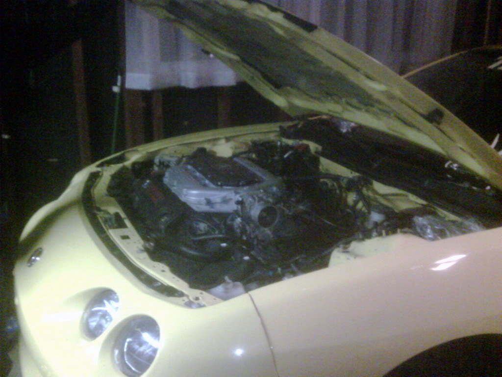

are you sure he didnt cut the hood out too?
i took a pic of this at Import alliance
the manifold doesnt even clear the hood skeleton even if it was lifted in the rear

I think you might need to be registered to read this, so I will quote a couple lines.
StlHondas
From the thread: I cut the webbing, swapped manifolds and lowered everything down 1.5in. The oil pan wont scrape. There is PLENTY of clearance...
I spaced down the mounts and subframe equally to keep the engine/ axle angles the same. It sits about 1.5in lower than before. I plan on compensating the height differences through the coilovers.
He is using a 09 TL 3.7 manifold so that there is more clearance. The engine is from a CL Type-S.
I like what he did as I am not a fan of the exposed engine look. This car looks stock from the outside.
