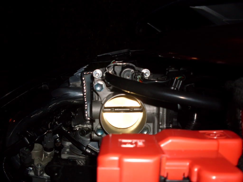

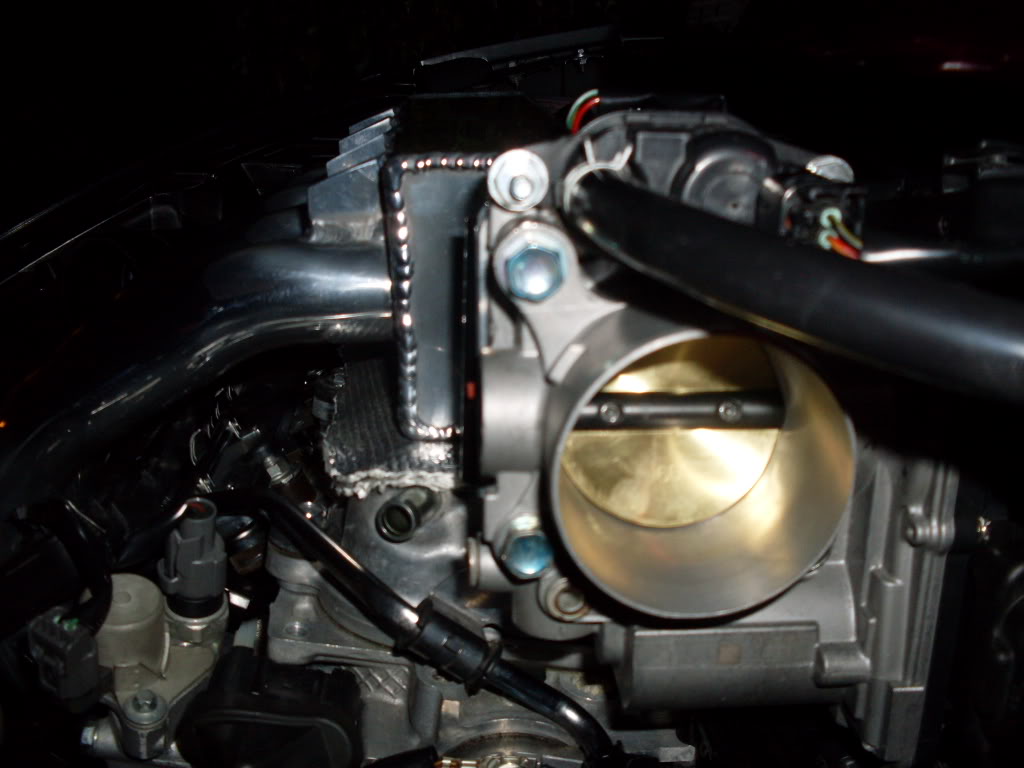

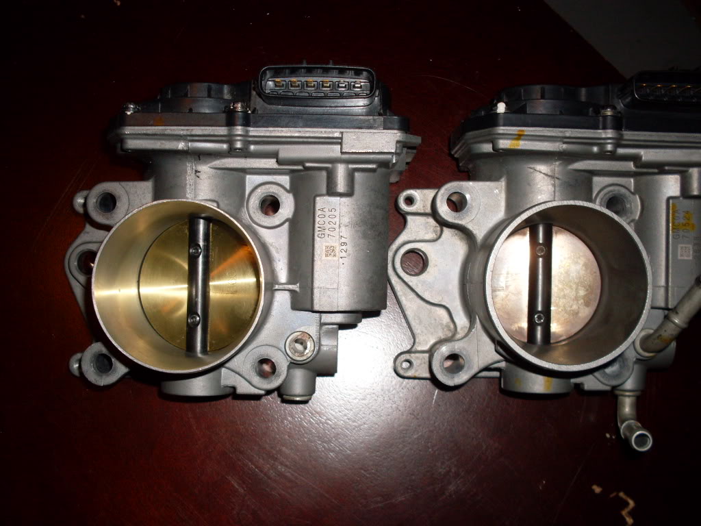

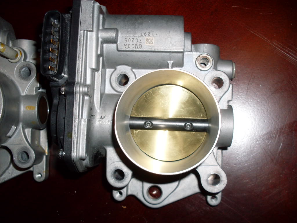

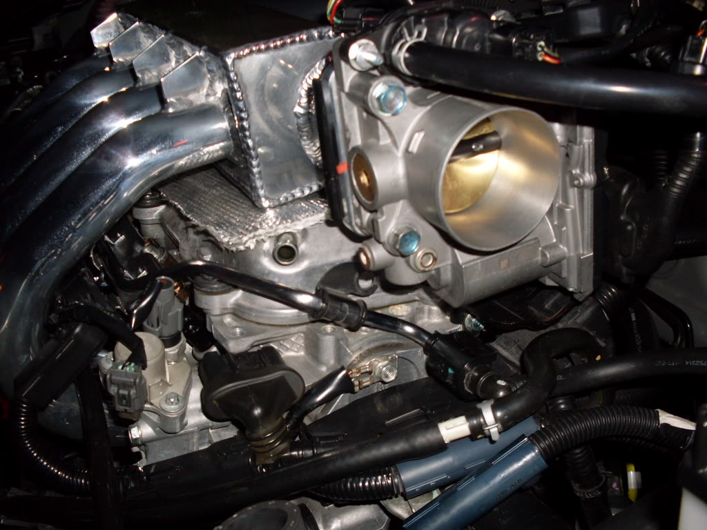

My 55mm throttle body!!!
Old Feb 19, 2010 | 12:04 AM
im the fit's Avatar
Posts: 787
From: plantation,florida
Size:  85.7 KBIts been three weeks and runs perfect!!
Size:  147.4 KBName:  SDC14336.jpg

Originally Posted by Tofuman
Is this a bored out OEM TB? From Maxbore or something? Looks rad. Congrats. + rep
You got it!! Yes, I got it bored at Maxbore for $75 including shipping..

who's throttle body is the other one?...can u lend it to me while i get mine maxbore..lol
The other one is mine!! If you want I'll sell it for $275 @55mm

Its kind of hard to tell in the pics, did they replace the throttle plate with a larger one? Did they knife edge it at all? Are you still using the OE throttle mapping, or are you running a Blitz TC? Sorry for all the questions, but i'm getting ready to send a TB out to Maxbore myself and was hoping you could answer some of my more idiotic questions...

Yes it now has a bigger butterfly with the TB bore of 55mm and yes you can use OE map....you wont have a problem with it.

I went to Maxbores website and they are quoteing 100 for Honda TB boring. I have an E-mail in to them asking about the L15, referencing the work they did for you. I see that you are running a CAI, did you notice any change in throttle response with the larger bore TB? I suppose if you did it wuold be hard to tell what with the new intake manifold and all. I just had top ask....LOL
Old Mar 4, 2010 | 04:26 PM
im the fit's Avatar
Posts: 787
Umm....im sc.....i tried the tb on my gf fit and had good top end.....like i said its better if your FI... just get it to 53mm like j's
