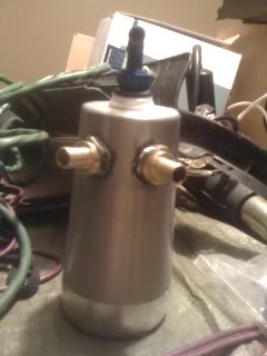

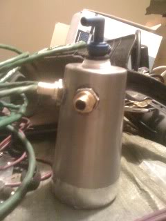

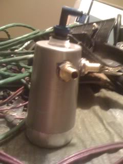

Well I made a catch can out of Walmart and Home Depot Products.
WALMART
1x Silver Ash Soap Dispenser - $10
Home Depot
2x 1/2 in fitting - $1.77
1x 1/2 in Tubing - $12
1x Pack of 3/8-7/8 Hose Clamps - $6
Note: I bought another part i might need at HD but I willbe returning it cuz I found a better way.
Already had Teflon Threading tape and RTV Silicone.
I got the soap dispenser took the screw on dispenser off and was thinking how i can use the top for my catch can. THen i thought "that'd be tite if the oring that was in my old b20 head for my pcv would fit in this top!" Well WTF do you know it did perfectly.
(ill get more pics tomorrow)
Then I drilled holes for the 1/2 in fittings i got from HD, threaded the crap outta them with teflon tape and screwed them suckers in and put RTV Silicone around the fittings gonnna let sit over night.
I also took the bottom off the dispenser , cause inside was plastic. And the top holding my PCV was part of that plastic so i couldnt eliminate it, and that will also sit over night.
I had to RTV silicone the top as well cause air was leaking from the top, then i wrapped it with teflon, so it doesnt move around for whatever reason.
I didnt take a bunch of pics cause im tired, Also changed my nephew transmission. SO im beat, here is my finished product.
Ill post pics of it after i mount it somewhere in my cluster fawked engine bay...
