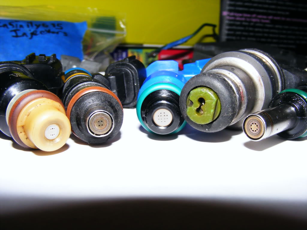

Well, here is a pic of all the injectors which have been on my fit.
From left to right: 2008 Stock Honda Fit Injectors, 2006 Infinity G35 Injectors, RDX (not sure what year), 1997 Mitsubishi Eclipse GS-T Injectors, and Mitsubishi Evo X injectors.
as you can see all the injectors are about the same size except for the eclipse injectors, which needs spacers, the RDX are actually a little taller than the stock injectors, so you may want to put in a washer or two inbetween the fuel rail and stock spacer.

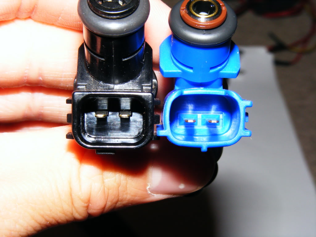

stock vs RDX plug length, supposedly you can use stock scion TC injector clips...
...the pins aren't exactly in the same spot either, the stock is slightly higher...

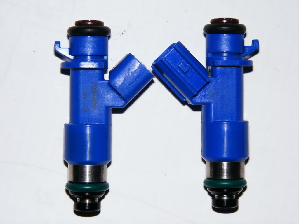

My modded RDX injector with the extra length cut off and the tabs filed down vs an unmolested injector
All i can say is, I'm running RDX injectors with stock clips that are held securely on with zip-ties (otherwise I don't think they would stay on very long or at all).
