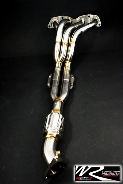

For an actual performance increase, depending on your local emissions restrictions, I would recommend the Weapon R Race Header.
You can pair that with any cat back exhaust system, or for probably 1/2 the cost got to a local muffler/exhaust shop and have them make a 2.25" exhaust to match.
