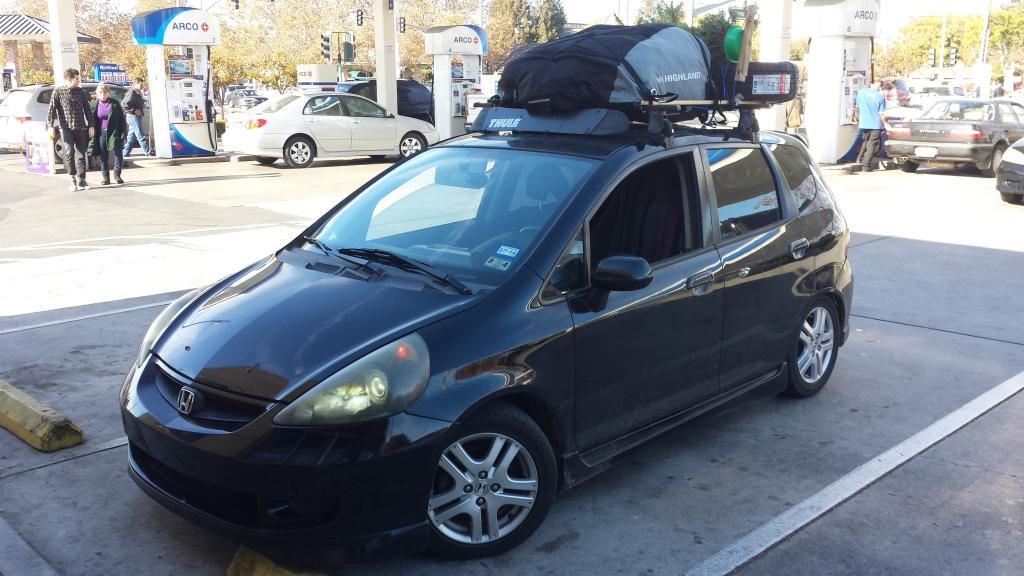

Cost isn't too much of the issue, it's the support. No one supports the SCs anymore, if KraftWerks was still behind their product 100%, I would have just purchased that.
But I'm also wanting to learn Turbos, as it's a more economic option (I know I said cost wasn't the issue), but if I make a mistake and I have the right precautions like gauges, alarms and etc, making a modification myself will be possible.
The issue is I need power at the 2k RPM range, and I want to coast at 60mph with load, or 70mph with load, or 90mph with about 600lb load... Sadly, I'm 200lbs, gf is 120, kids are 30 and 35lb, and the road trip equipment is another 300lbs or so (two spare tires, clothing, stuff I purchase while on road trip).
So, back to the question, is there a smaller turbo to give the power at the 2kRPM range? or will the SR20det have what i need without having to downshift to get back up to the speeds I want (downshifting == poor gas mileage).
