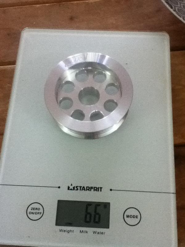

Alternator pulley was a few grams heavier at 66 g:

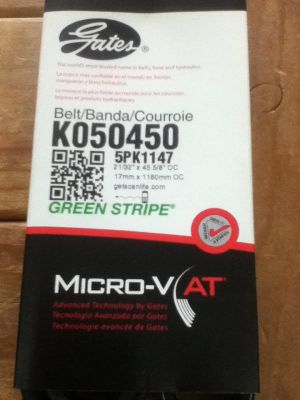

I didn't realize that a serpentine belt was also included in the kit:

different belt means something is underdriven for power. Keep an eye on your charging voltage at idle. Should still be over 12 volts if you expect to keep your battery alive during stop and go traffic

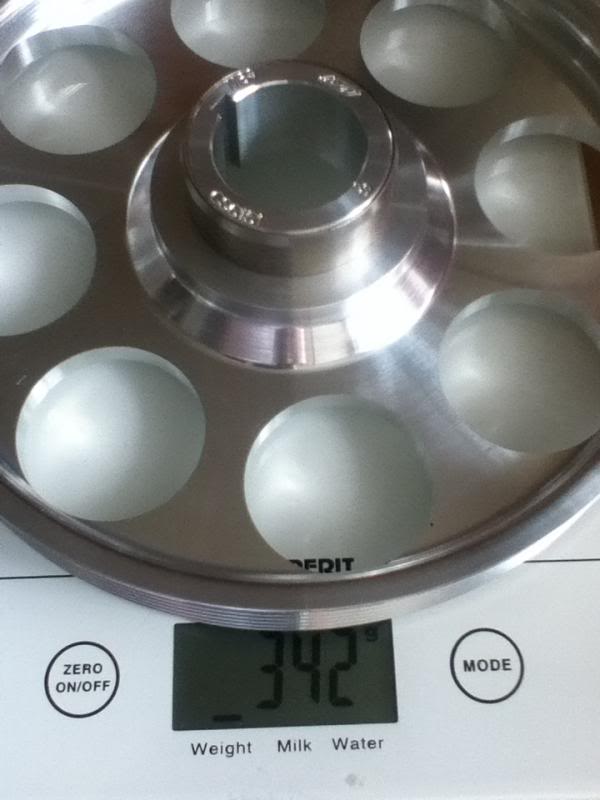

It looks like the GD pulley is now 342 g (0.75 lbs) as opposed to the original weight of 461 g (1.01 lbs). :-)

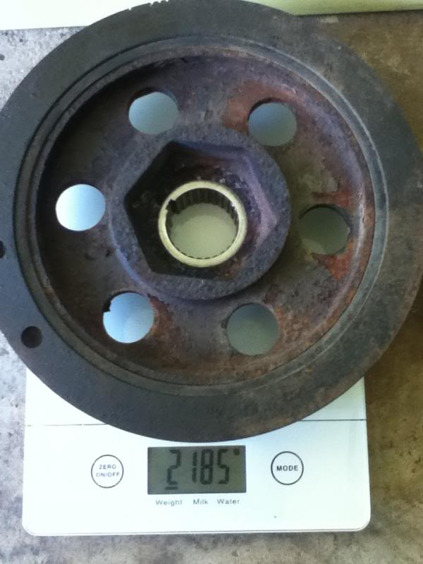

Had the pullies installed today, took some pics of the OEM weights:
Stock crank pulley 4.82 lbs or 2185 g.

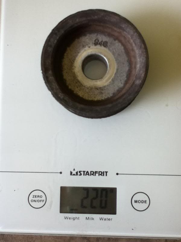

Stock alternator pulley 0.49 lbs or 220 g.

4.07lbs reduction in rotating mass at the crank is significant in my case. Especially for such a low hp car like the fit. Thanks for the scale info. Really appreciate it. I NEED this for the 2015 Fit if it 'fits'.

4 pounds is a lot to remove from rotating mass, but it is hub center mass that is being removed. half a pound off the flywheel on the friction surface area would be more noticable then 4 pounds off the pulleys
