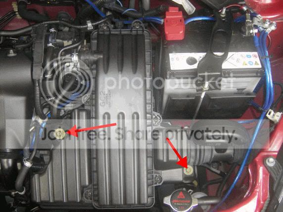

Engine Bay
Take out these nuts

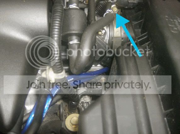

Gotta loosen this nut

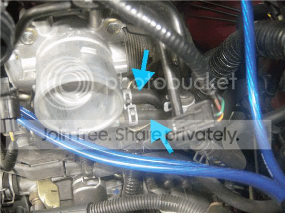

These are the coolant pipes going into the TB

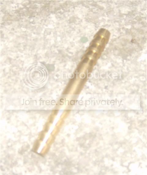

Here's the brass connector, bought the wrong bloody size twice

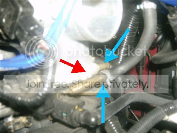

Attached one side (BTW, what did the coolant run thru previously? It's like some kind of plastic covered thing)
Done!!
join up both hoses to the brass tube, sorry. I accidentally trashed the pic.
Verdict
Easy to do. No noticeable effect (damn).
