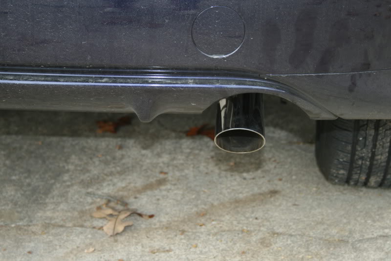

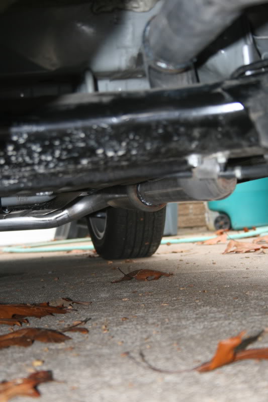

So, I dropped by a well known local muffler shop, and paid 120 for a 2.25" cat-back exhaust system that would have cost me well over 250, if not, 350 USD. For a muffler, I used an 18" glasspack muffler where the resonator used to be. Needless to say, there's no resonator.
Pictures (They're large):
Kind of a messed up pic, that shows the muffler.

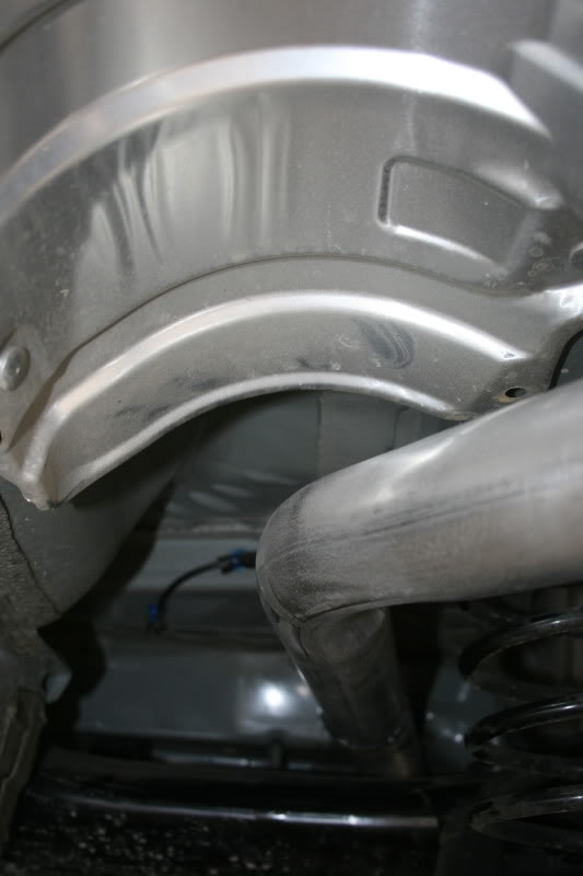

They used a nice, smooth bend for the axle-back, instead of a harsh 90 degree bend.

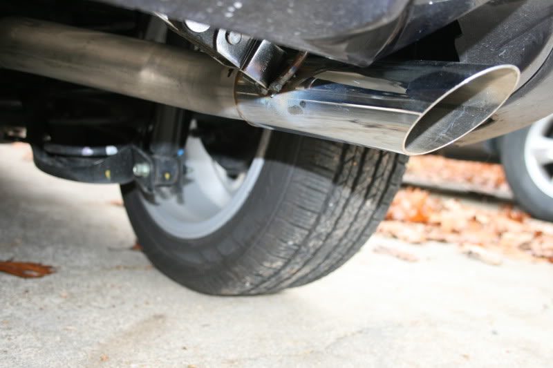

The tip and axle-back part.
Rear bumper.
So far, it seems to do what it's supposed to. The car is much more responsive and a little quicker. I got my money's worth, that's for sure. Beats paying 350 for the same thing.

those aren't mandrel bends (correct me if i'm wrong) and the fitment could be improved. your tailpipe exits off-center of the bumper cutout.
i'm going out on a limb here too, but the low cost has implications on the quality of the materials - i wouldn't be surprised if this exhaust weighs more than the $250-$350 exhaust systems you're comparing yours to. if yours weighs less, it'd probably only be because it's lacking a muffler at the rear. but if you did get a muffler on there, it'd tack on an additional $40-$60 depending on your choice of muffler. I had one of these custom exhausts before, and it corroded a lot quicker than a high-quality system, especially at the welds.
i don't want to hate or anything, but the price of the exhaust reflects many things. the difference between a $350 exhaust and your $120 exhaust does show. a lot of people read forums like it's the bible, so it's misleading to state that you got the same thing for ~1/3 the price

They probably are not mandrel bends, but as far as weight goes, what does it really matter? 5-10 pounds won't matter much on a daily driver. And if they deteriorate, they deteriorate. But by the time they do, I'll be in a better position to pay 300-600 for a full cat-back. Right now, I'm an 18-year old high school Senior without a job, so I'm making do with what I can. And besides, I'm satisfied with what I have and that's all that really matters. I mean, it's an open forum, so everything is open for debate, right?
And as for materials, I know they used Aluminized Steel with Mig and Tig welding. And it does have a muffler. They used an 18" generic glasspack where the resonator once was.

crash001 is right, i'm not trying to give you shit, i'm just saying there are differences between your setup and an expensive one. nothing wrong with it, i did the exact same thing with my car when i was a high school senior

Ah, alright, sorry if I attacked you like that, wasn't meaning to sound so aggressive, lol.
