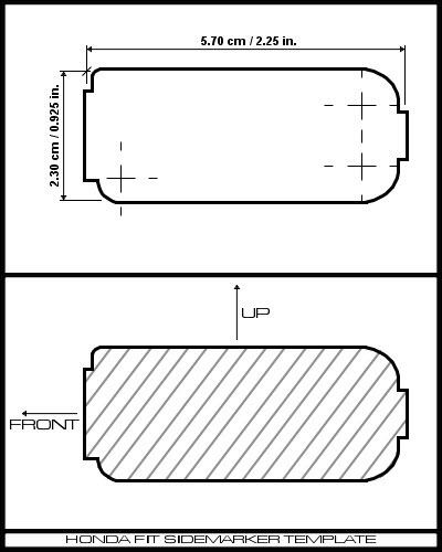

Hey how do you print this out so that it's the right size? I've tried like 4 times and I can't get the size right.

For those of you that just used a dremal to cut out the holes for the sidemarkers can you tell me exactly which tool you used? ie. cutting disc, drill bit, etc.
I'm waiting on my nibbler tool to show up in the mail but I might want to just try and go ahead with the dremel instead. I want to go get some new bits for it at the home depot though depending on what I will need.

i used a cutting disc for the whole process. i did the intial cut with the disc, and then just filled away at an angle with the disc. some of us are to broke to go buy the file extension thingy.

Cutting Disc. Buy a pack of 30 cuz they break alot. Make sure to cover the area you will be cutting with painters tape. Then put the template over.

I made a templet out of plastic. I basically made a sidemarker hole in a thin piece of plastic before cutting into my fenders.
I measured out the location as per the instructions but the center of where the sidemarker would sit. Used a grease pencil and wrote on my fenders.
I put up my templet, traced it and cut away.
I used the discs for the whole process. I didnt break one disc. Used the same one for both holes.
When cutting. Slowly push the disc into the metal starting at the center of the sidemarker outline. Then slowly work your way left/right. This prevents from making the whole too big.
Start small and work make it bigger.
I actually shaved down the little ridges ON my sidemarker instead of cutting the wholes bigger.

My apologies, as I too just realized that when I was rushed into actually making the template, I unfortunately didn't check to see if the printed scale was set correctly. I will try and correct this problem ASAP, but for the time being this can be used if you ignore the body lines.
http://forums.clubrsx.com/attachment...2&d=1136859615

I know this is late for some of you but I do have the template proper sized and am willing to send it to your email if any one needs it. The one I have is for the DC5 markers.
